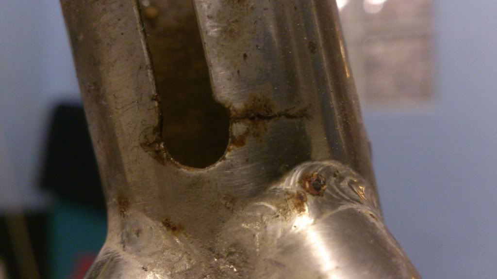

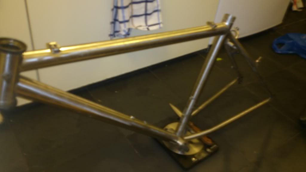

This frame is extremely light at 2045 grams with bottom bracket and headset cups. It gives a ringing 'ping' when tapped with a fingernail. With the canti hanger and Ritchey dropouts I'd say it's a very nice frame. The rust looks worse in the pics and I think would clean off easily.

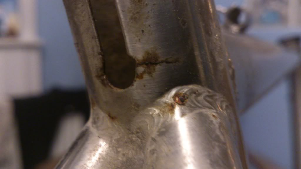

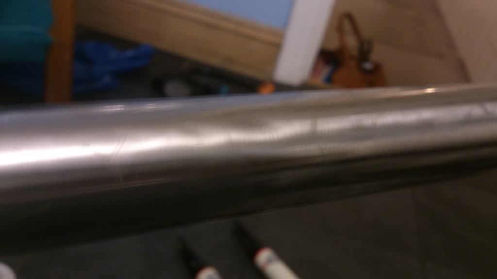

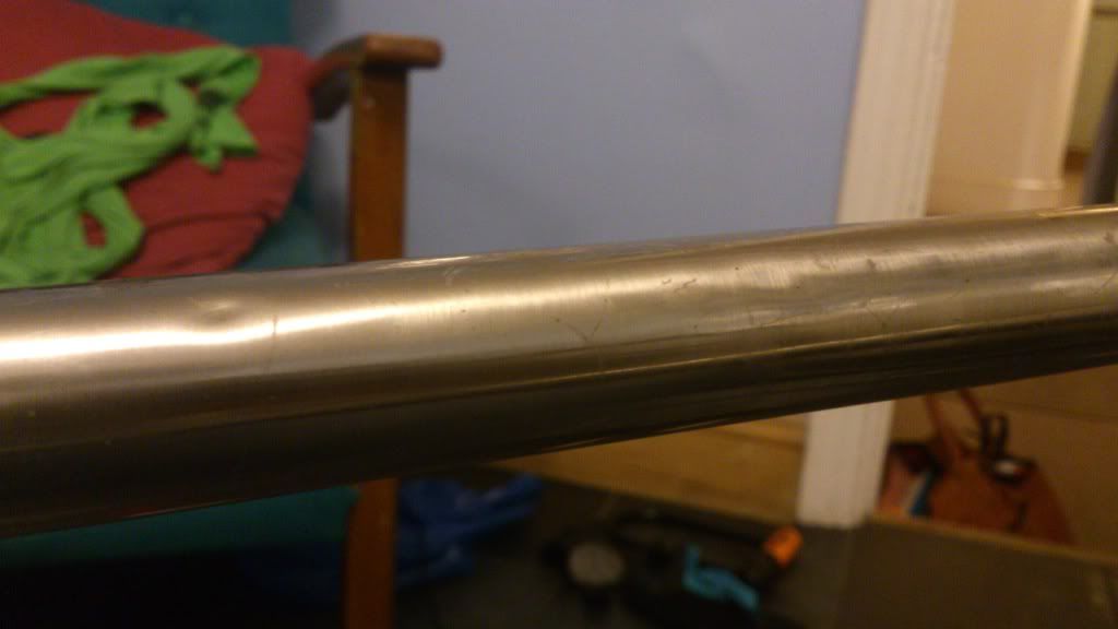

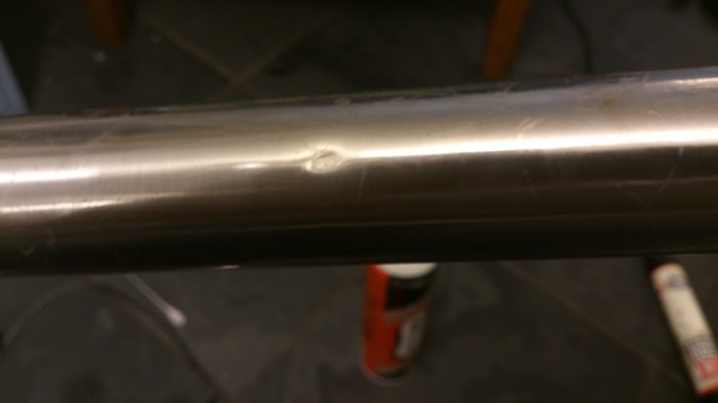

Trouble is it's so light and thin it has a few minor dents and ripples and - more seriously I guess - a crack at the seat tube slit.
If it was just the dents I think it would probably be ok. If it was just the crack I guess that could probably be repaired. The two together - I'm not sure it's worth doing anything with.
The dent you see twice is the same dent.
Any thoughts?
Shame, that must be very light for a steel frame, well under 2kg/4lbs. I wouldn't worry about the dents, but I think the crack would have to be repaired before you could use it.
Might be worth contacting a frame builder to see what can be done and how much it would cost. They may be able to weld the crack then grind it flush, or perhaps braze a short length of tubing over the top of the existing seat tube, then cut a slot in that to use with a larger diameter seat clamp.
drill the end of the crack to stop it propagating. run a loooooooong seatpost. check it regularly.
