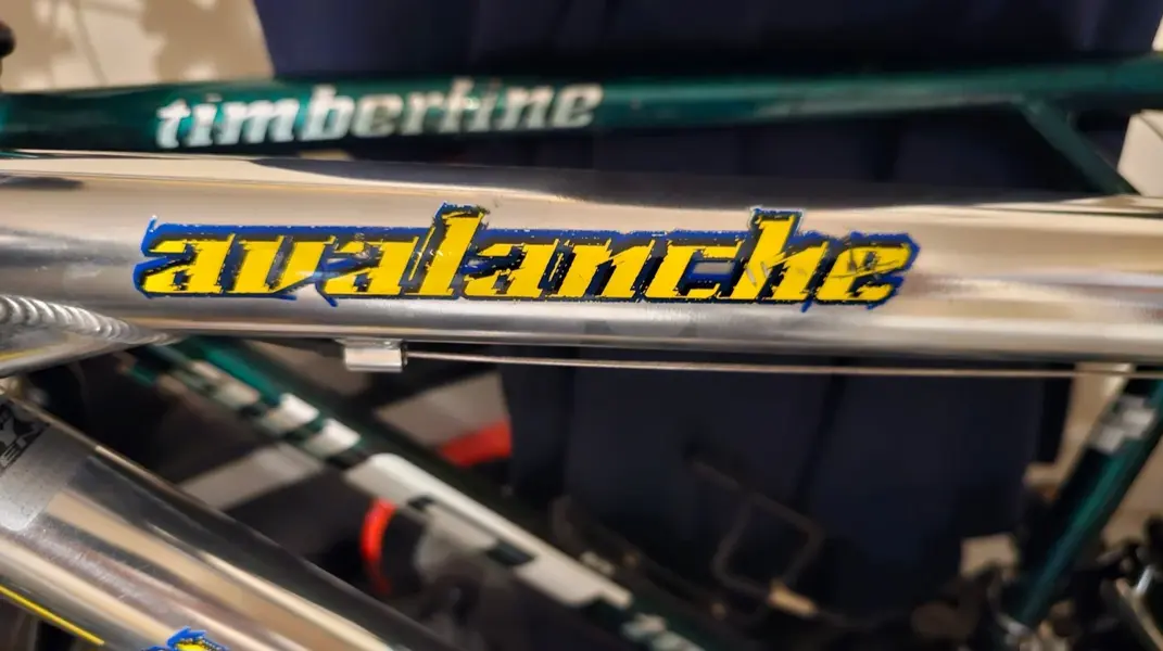

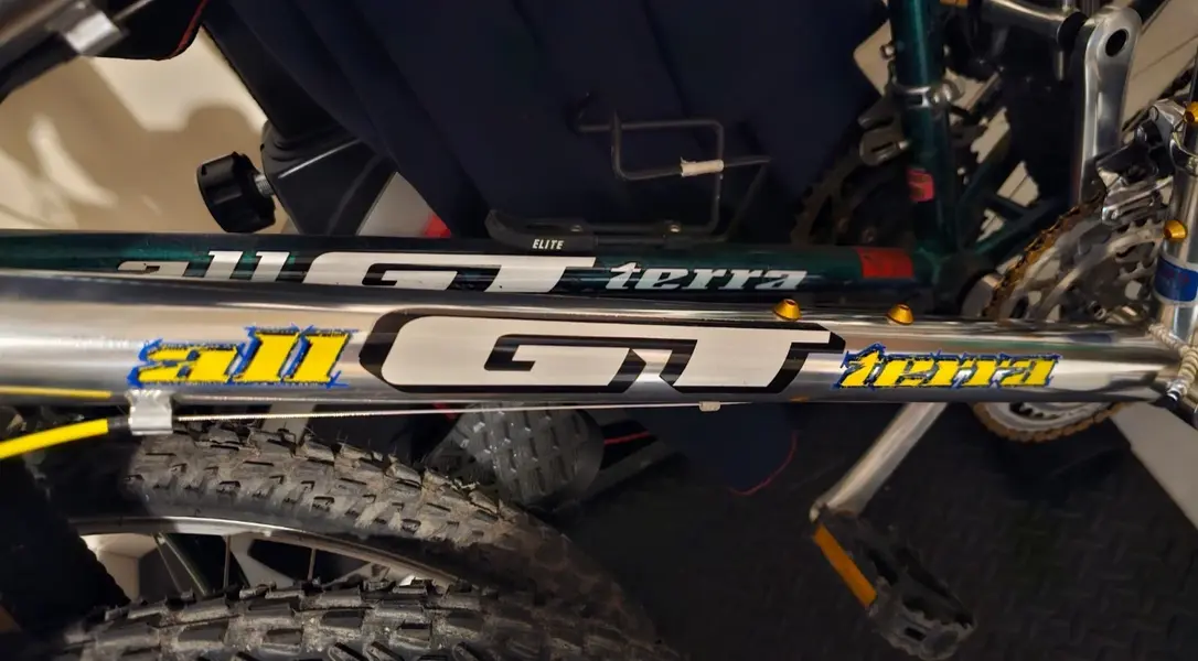

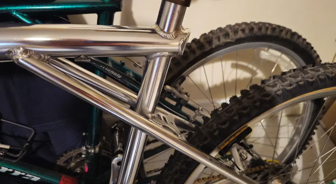

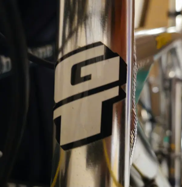

Hello.
I would like some help confirming the frame year. When I purchased the frame it was listed as a 1993 but after looking at the numbers it might be a 1994. The characters stamped are H4C06944. Can anyone confirm this? Thanks.
