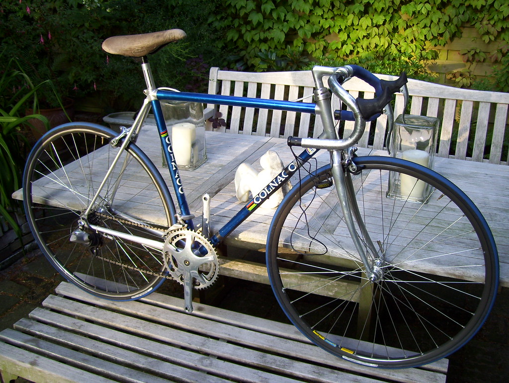

Today I got my hands on this 'Colnago'. Well, the only thing Colnago on this bike are the decals. It's actually a Vitus. There is also one Buckler sticker.
The bike is equipped with Mavic Zap. Electronic gear change by Mavic.
It needs a cleaning, a polishing and hopefully only a new battery. The Zap isn't working yet.

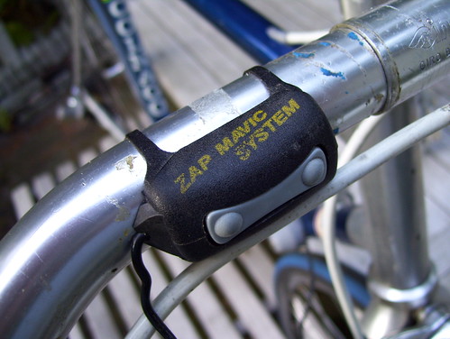

There are two of those units: One on top the bar and one under the brake lever >>
In the right bar end the battery can be found.

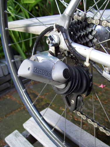

The mech >>
Only the rear mech is electronic operated.

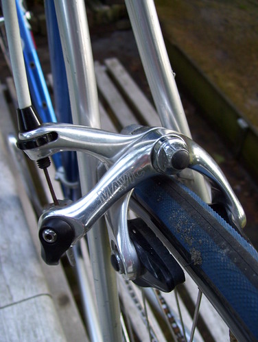

Old fashion by hand power operated brake >>

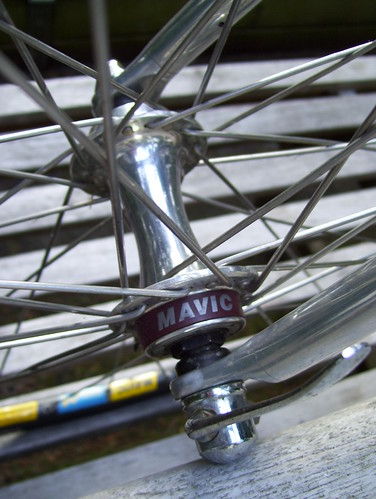

Not forgotten: Proper bearings 8) >>

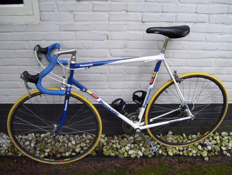

If so, I could consider the following: As you know I have two Panasonic PR-6000 roadbikes and both are equipped with DA7402. If I want a little variation going for Campa is not really an option, as I think it would look poor on the PR-6000 frame. In my view the Zap would be pure class instead.

Looks good, same frame as mine - but smaller.
Surprised to see the Colnago decals. I thought they used Alans for their Aluminium models.
Interesting to the the ZAP fittings. Hope you can get them working. Didn't GAN try them for a short while (eg Chris Boardman's time trial bike) but decided the technology wasn't far enough advanced to be totally reliable?

Just came back from the shop where they sold me a fresh battery. No cheapy with 15 euro, but okay I justified it for myself by that is for something exceptional.
Okay, the verdict: Works flawlessly!
So the system is working!
Funny thing is it seems the mech is only is moving when the top pulley is running. To protect the mechanism?

Panasonic PR-6000

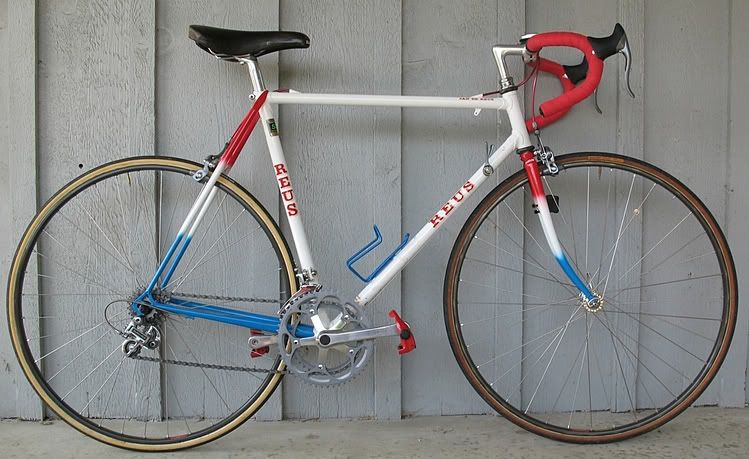

Jan de Reus
Serotta
The Panasonic would be the cheapest option. I already have one available for the purpose (not the one pictured), plus I would end up with a new condition DA7400 groupset for the sparesbox.
A roadbike by Dutch masterbuilder Jan de Reus is missing in my little collection of vintage Dutch roadbikes. Very neatly made frame. Rare, not easy to find one.

The zap draws power from the chain to move the mech, that's why it doesn´t work when it's stationary. The zap is a rather quirky piece of kit, I think it deserves a place on a bike that was somewhat groundbreaking in it's time in terms of materials used or aero design, something like that.
