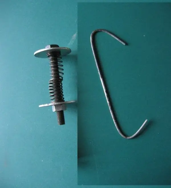

These home made tools save me a lot of bother.
The one on the left holds the BB extractor on firmly to allow me to apply pressure via the spanner without it slipping.
The one on the right is a bent spoke which clips the rear mech arm close to the chainstay to make chain removal/fitting much easier
Nice idea. I've just had dramas removing a nylon BB cup. Insufficient pressure was a key reason why the socket slipped & knackered the plastic splines. Leaving me to use alternative method for extraction...lessons learned!
I'd like to make one of those. What's the outer dia of the two repair washers? Is it determined by the inner dia of socket shaft?
As long as the washers are bigger than the diameter of the bb removal tool you'll be OK. It needs quite strong springs to exert enough holding pressure. I'm not sure of the correct size bolt to fit into the bb axle as it was just trial and error with bolts I had in the shed and luckily I had one the right size.
1.5" washers, 3" bolt and springs from an old bike pump.
It's made even very stuck BBs a one-man job and hasn't failed me yet.
