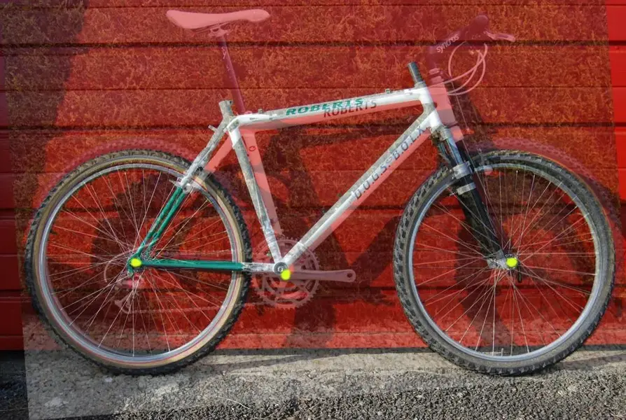

I just did a quick photoshop to help you compare angles, I overlaid one picture over the other and adjusted the dimensions and rotation to compare the angle a bit better.
the pics weren't taken from exactly the same angle so it is distorted to some extent, but looking at it, with a bit of sag, I think the RC36 will be fine.
(mind you I ride a chopper of a quake! ;-) )
Hope this helps?
DB
Sorry fella but it will handle like a dog with those forks on! Pace are a bit different to lot of other forks, which make the situation even worse.
They have a fair degree of "lead" or castor built into the crown, i.e they achieve the necessary castor, by angling the stanchions and sliders forward by about 4 degrees.
Other makers achieve this by either placing the drop outs well forward of the sliders or casting the crown with a forward bend in it, or like MZ both.
With all these options the steerer angle and slider angles remain the same, not with Pace, so the effect is to make the "virtual" head angle much slacker and the forks rake forward too much.
It's not just tipping the head tube back, like with using over long forks then, the steering will "flip-flop" something terrible and you'll end up losing most of your teeth or worse. (it will understeer on loose surfaces like a pig) Ask Jez or Jerky, they suffered just that.
Most of the UK builders, Yated, CR, Dyna tech etc all suffer from this. So be warned! I would run it rigid with no more than a 40cm atc. It'll kill you otherwise. :cry:
There is no need I have stated it above not with guess work or photo shop but with two living breathing examples in the garage, I dont often get wound up but this has :lol:
And the whole "sag" thing is a load of balls too , Great if you only ride over the bars or downhill , Try some technical steep climbing and see how the sag helps the handling then ...Again experience actually riding roberts frames not "think" or "looks alright"
Sounding obnoxious i know but I dont understand why people are feeding advice when its a proven fact? :?
