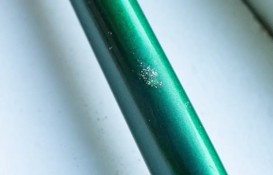

Getting the colour right is of course an issue here and I'm writing off my 7 quid on nail varnish as a failure - the colour was a bit off as expected but the much bigger issue is that the metallic nail polish has MUCH bigger and more obvious flakes than the original paint - almost feels like someone threw some glitter at it :)
It's a little weird that even slightly bad repairs tend to actually look much worse than the original damage. Gonna maybe look for some automotive paint or miniature style enamels and see if I can find something better. Time is of course the main thing as you say - but feel like I'm not quite ready to give up yet :)

once it dried the nail varnish actually wasn't that far off colour wise - the flakes though (lets just call them glitter) are another story!
This hasn't properly levelled out the chip indent, nor been flatted back adequately but you can see the issue :)
