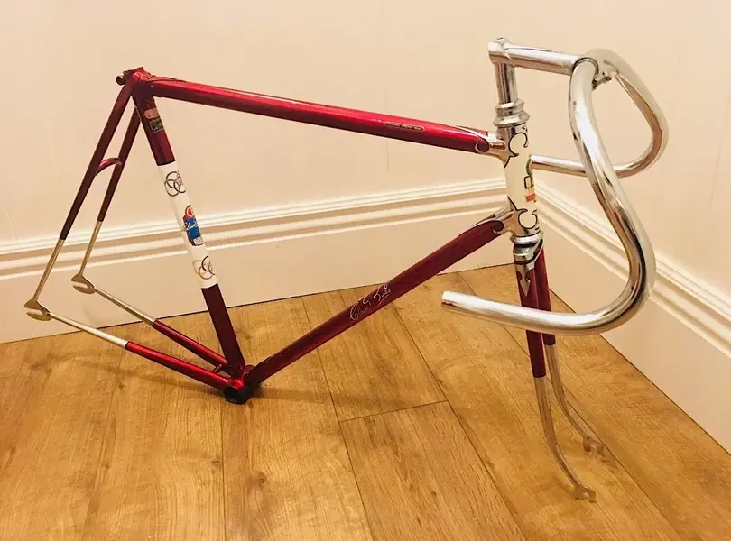

Here’s my ‘51 Olympic Sprint..... although the photo was taken indoors so it really doesn’t do it justice...

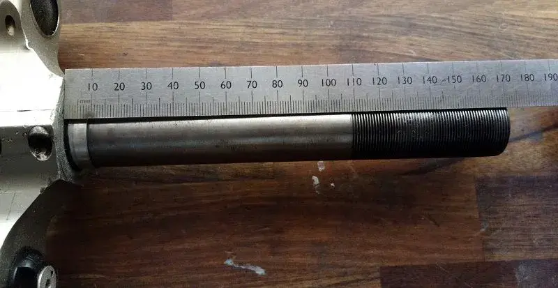

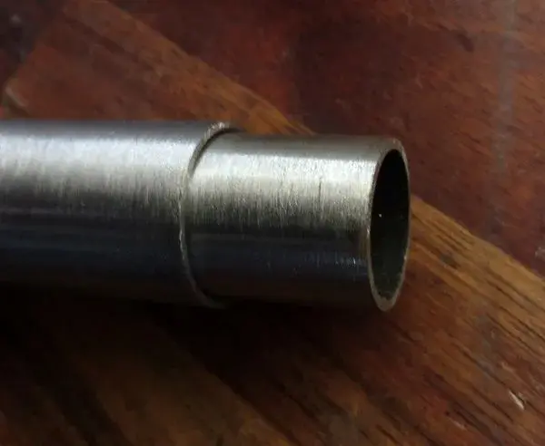

Firstly the Pace Steerer that was too short:
Looking for 216 + the 30mm for the crown:
Simple enough, no welding or brazing involved...just find a 1" steerer that's the right sort of (long) length:

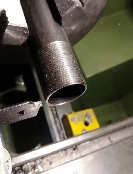

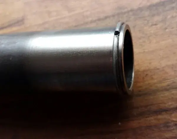

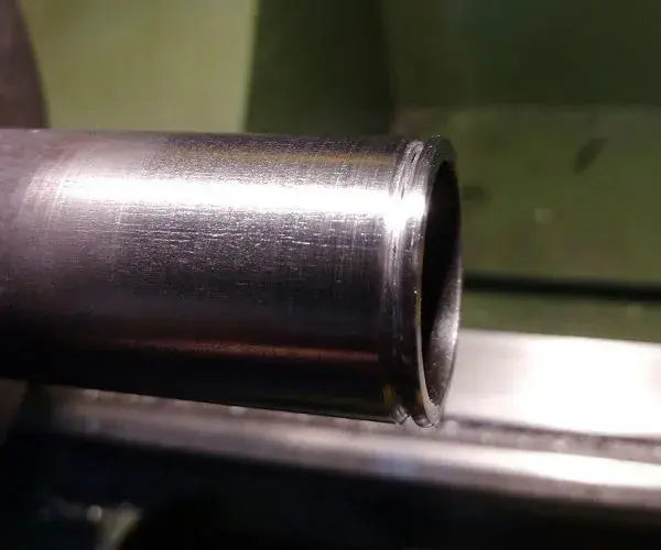

Onto the lathe to put the circlip groove in the bottom end:

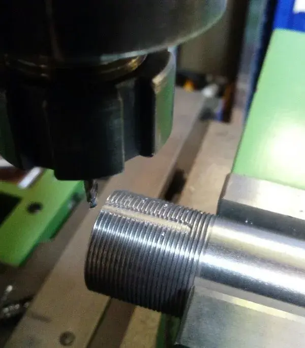

Part off the threaded end to length:

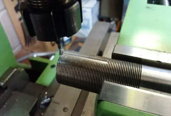

Mill the slot for the tabbed headset washer:
File off any burrs on the milled slot and Bob's your uncle. :-)

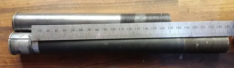

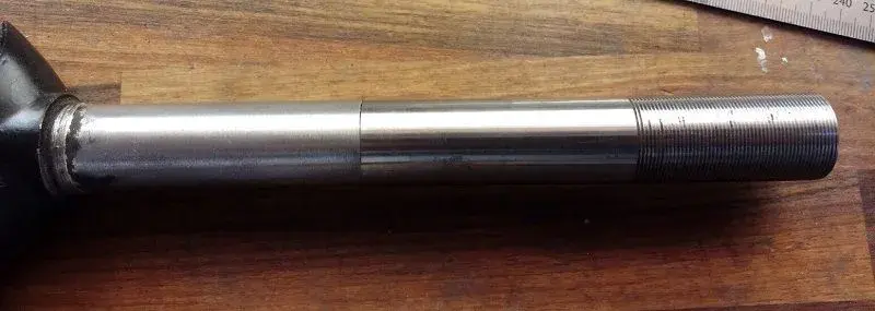

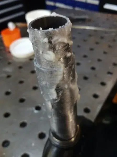

The unicrown fork:
Again, too short in the steerer, needs to be 216mm:

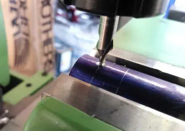

Cut off the old top section at a point that isn't into the internal butt near the crown, or too far up that it will interfere with the insertion of the stem quill...In this case around 80mm from the crown race.
Cut a 40mm long 22.2 OD tube as an internal shim:
Cut a new top section to give the required length:

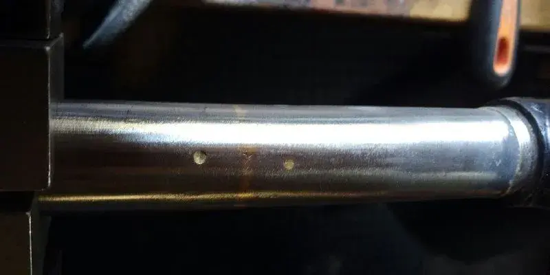

Cross drill the fork and top sections to give viewing portholes to check brass penetration:

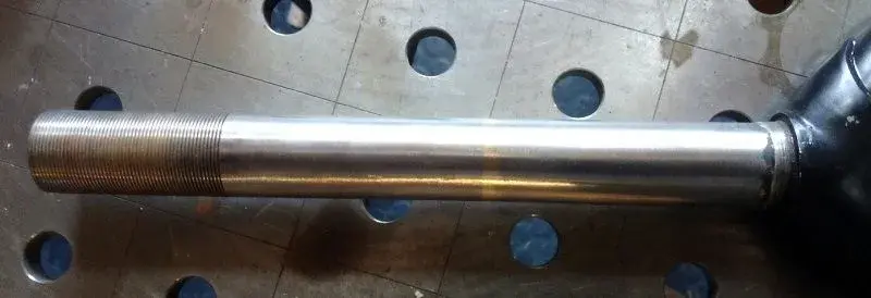

Braze the internal shim int the fork, clean up, then braze the top section onto the fork, sweating the brass out from a ring of brazing rod inserted inside above the shim:
Clean up brazed joint:
Mill 3mm wide slot for the headset tab:
Finished:
