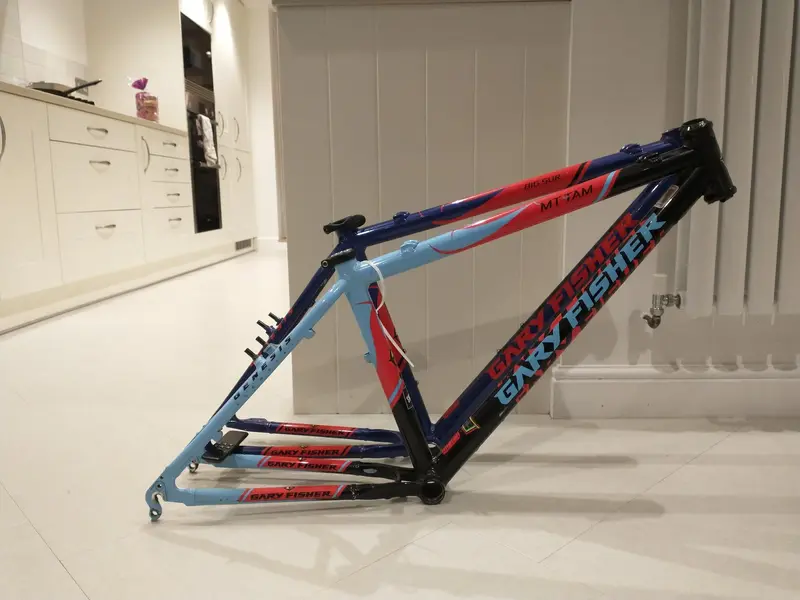

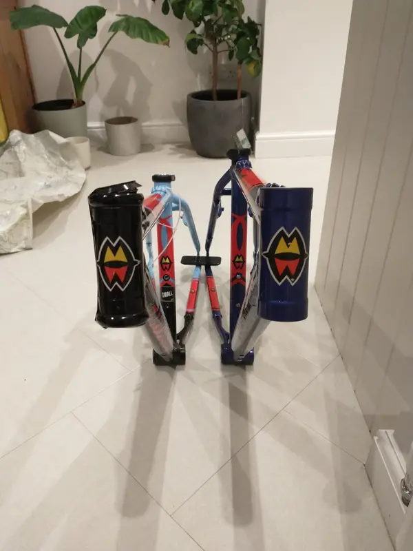

Retrobiker reluctant had a beautiful condition 2000 Big Sur frame, size medium, on here for £40... Then same time spotted a 2000 Mt tam, size small, on gumtree - bought off a lovely bloke for all of £30. Essentially the same frame geo-wise, great condition, in two sizes to try on for not much money. How often does that happen?!
Going to transplant all the kit from the '98 p7 frame that's going out the door onto the Mt. Tam, give it a go, then do same again with big Sur, see which (if either!) fits feels/best.

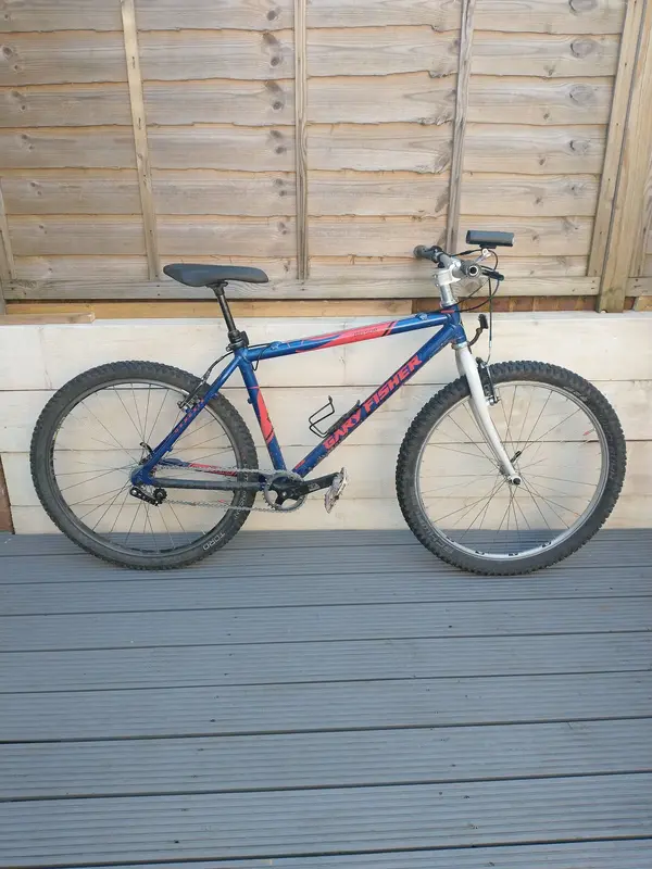

Got everything swapped across ... Desperate to get out so literally pulled off p7 and threw it on to the Mt. Tam, so this is not the prettiest 'build', with some pretty chatty indexing and out of sorts brakes due to sub optimal cable outer lengths etc...
But Christ what a bike! Even with me well out of shape it was a hooligan through the woods last night, snorting through twisty single-track, going like sticky sh!t off a stick out the saddle - and the thing hops like a march hare on a hotplate. Grinning from ear to ear rolling back into town...
Will run this probably to other side of Xmas, then give the Big Sur it's turn, but sorely tempted to stick rather than twist on current evidence!

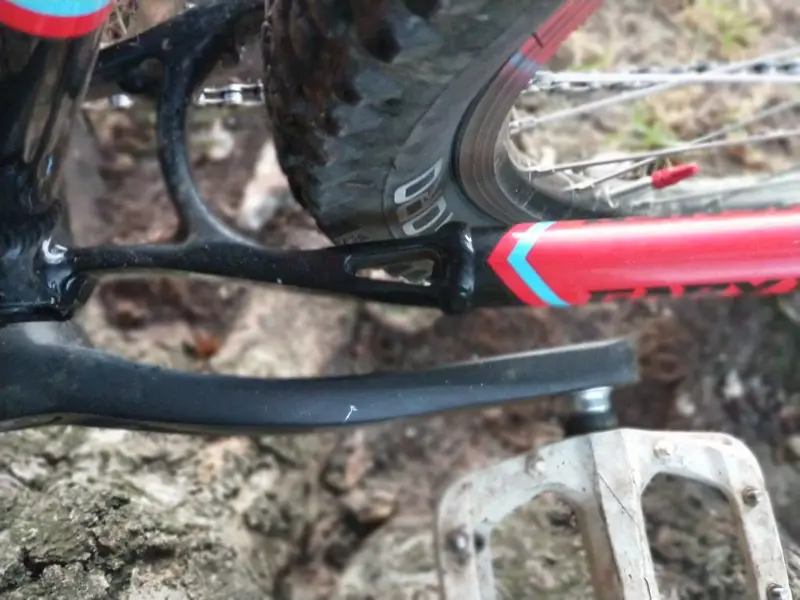

Cheers; I like the detailing on these - I know Joe Breeze says minimising joinery is the holy grail, but I really like the chainstay bridge/gusset on these - sort of Victorian railway station ironwork chic!
I know what you mean, I had a Coyote HT5 frame with a similar detail and always thought it looked nice.

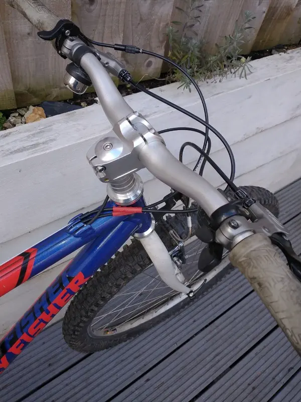

Finally built up/swapped over to the larger of the two frames, after mangling knee coming off the Mt Tam in the early January wet. Knee still dodgey, but been able to atke this out for a couple of shakedown rides around park/town - 1st impressions are its's really good, especially cornering.
Swapped 60mm stem out for 40mm as hands were feeling the extra length/lean forward and better for it. Sum total of ETT and stem length same as Mt. Tam, but 20mm more in the ETT. Quite sharp handling with that stem...suits me fine - but goes where you look instanter, so you need to be looking where you want to be going, always!
