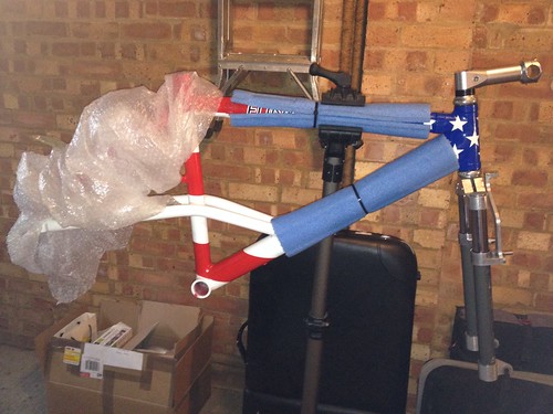

OK heres the acquired parts list so far:
Manitou One forks - new steerer arrived today and once I trim the threads it'll fit nice i think.
Silver Ringle Zooka stem
Silver King headset already fitted
SRAM Betsy Rear Mech in USA flag mode it'll work well
SRAM 8 speed red gripshift - couldnt find any good betsy shifters just yet so these red ones will do for now
Silver Paul Component Cantilevers and Moon units
Possible parts:
Ibis ti flat bar - in a box but not sure they'll work
Wanted parts:
Cranks - hmmm no idea yet
Wheels - fancy some King silver classics
Still looking for the betsy shifters in case i can find some
Then the rest will likely be a mix of m900 xtr
The manitou steerer has been the hardest bit so far, the orignal wasnt long enough but on Mnai Ones the steerer can be removed from the crown so I've sourced another and will cut the threads off and the zooka is a faily small stack height and it looks a good fit. I'm umming and ahhhing about getting a machine shop to drive a groove for the circlip as the original had. I wont be riding it much but will see if it seems a good secure solution or not.

A small update. After a lot of faffing searching for steerer tubes I finally got the Manitou One fitted.. Topped it off with a ringle stem and now the build is underway. Bottom bracket next as I've got some luvely Syncros silver cranks. Anyway ... I'll add a pic soon.
Re: Look at what just got delivered : The Yankee Funk Build
ti_pin_man":b2bwwwbs said:
....Bottom bracket next as I've got some luvely Syncros silver cranks...
The silver Syncros cranks are somewhat too young and they have a tendecy to crack. Just in case the bike is not intended to be a "wallhanger".
