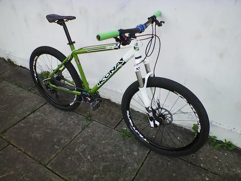

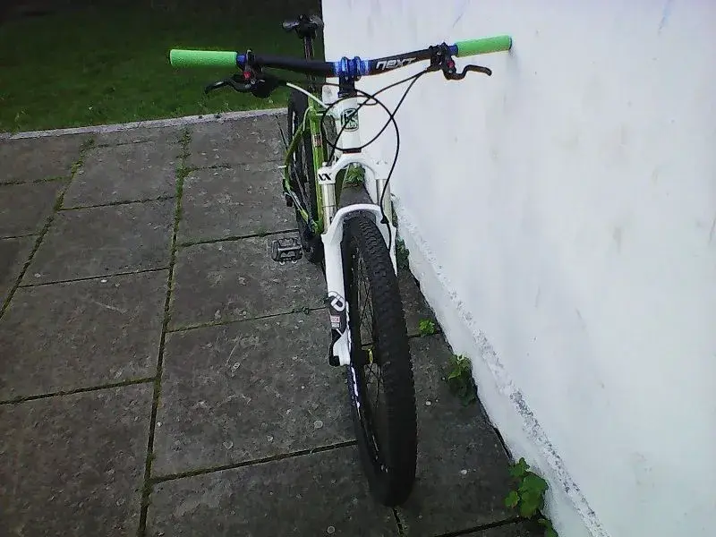

I'm getting some RaceFace Next carbon bars next week. As I mentioned earlier I want to add a dropper post too but the seatube is 27.0mm and the smallest post I have found is 27.2mm. Might have to get the seatube reamed out :shock: . Tyres will be Rocket Rons running tubeless.
This will be the bike that gets me back in the saddle riding again after 10 years away and I cant wait! Cheers for reading 8)

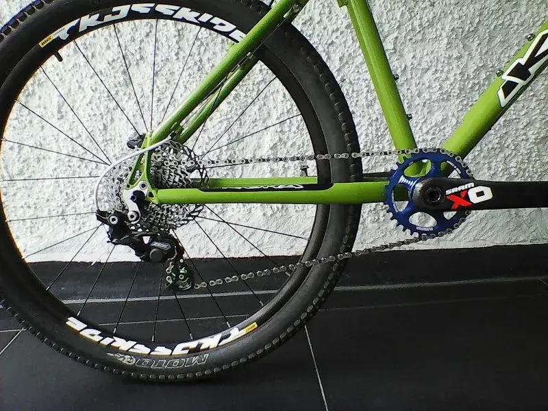

Forgot to mention. Shifting is taken care of with a Shimano Zee rear mech & shifter and a 11-36 Sram cassette. I love the short cage on the mech and its pretty light too. I was lucky and got the brakes mech and shifter from a guy for £65. Also got the cassette for only £15 which had been hardly used. Pinkbike bargains!
