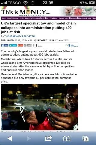

Come on people get buying XTR grey and save modelzone before its too late")
Apologies for ranting - the administrator's will honour vouchers but for only.50% of their value.
You can bet Deloitte insist their bill is laid 100% though.
