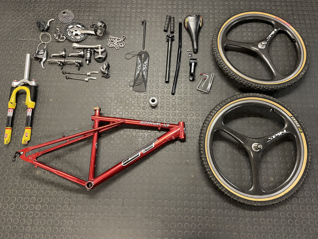

Just gotten myself a 96 Zaskar LE and need some info from veterans out there.
Apologies for the noob qn.My frame comes without the original part and I would love to use back original parts in it.
Is the 96 LE equipped with M900 or M950?
Are they interchangeable and can both be used in the frame?
Appreciate your time to answer this noob an. Cheers!

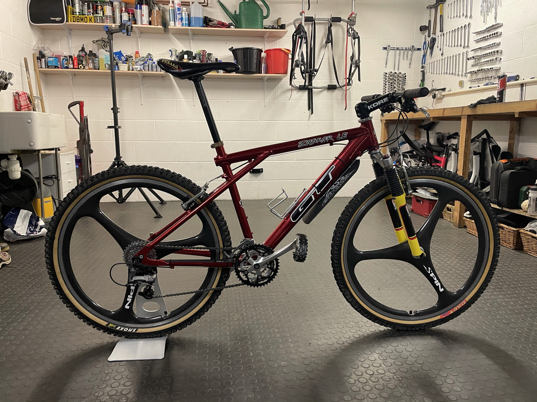

Hi Reddysan,
I’ve just bought a March ‘96 16 inch Zaskar LE.
Mine has a random mix of parts on it, and was also wondering what groupset to use. It was relatively cheap, so under whether to go for era correct XT, or go the whole hog and source an XTR groupset.
What did you opt for in the end? Do you have a build thread for the bike?
All the best, Paul.
