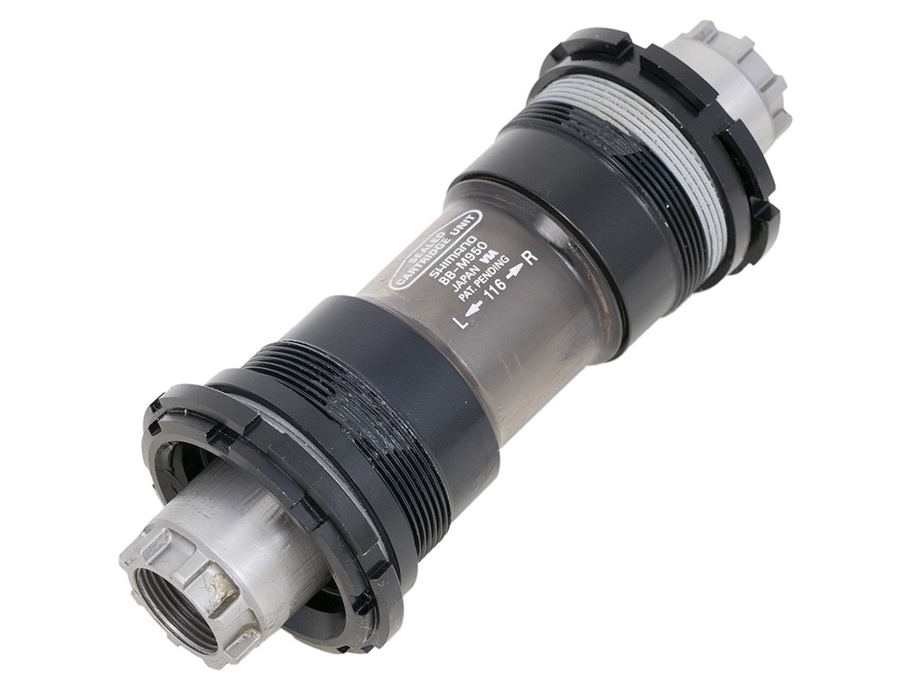

Hi all hoping the hive mind on here can help 😊 On an xtr m950bb does the lock ring go on the non drive side or does it matter 🤷‍♂️
I removed the bb from a doner bike and can’t remember which side it was on 🥺
I did look at that doc(obviously not close enough) it clearly shows lock ring on non drive side. I’ll have another fettle tomorrow 👍🏻
The other side already had the lock ring 'built in' to the cup
and don't forget the correct spacers for your new setup.
Anyway three more at shimano.
https://si.shimano.com/#/en/search/Keyword?name=BB-M950
and here is a picture to help out (note the L & R )
