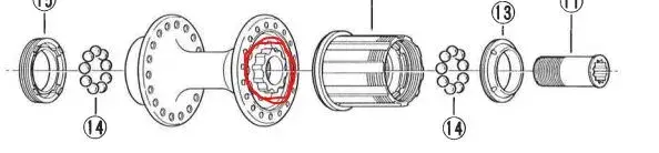

Is it me, but on the first picture the little rounded notices on the AL hub where the freehub body locates seem to be stripped off / hidden under crap? That would explain why the freehub body fell to bits?
What you are seeing is the innards of a freehub body, that it the stationary part as is currently mounted and covering the notches.
The notches being the part that keeps that bit stationary.

AHH looking closer at the very front, that's shattered of and very damaged.
Take the big 10mm bolt out, buy a new freehub. buy a new cassette.

Perhaps I wasn't clear, see the red circle over the nubbines spline that appear missing.
I can't see how a new freehub body could help.

OK, scrap that. Now I get what you are saying FC. The fixed inner portion of the freehub is still attached to the main hub body.
Blimey, bet that made a bit of a racket when it all exploded. Where are the pawls and the spring....still on the trails ;-)

I still have he missing bits (pawls and all), so i didn't hear it explode :D i got it like this and the hole thing was held together only thanks to the bearing cones. What may be broken is the threaded bit holding together the inner part (with the pawls, attached to the hub with that 10mm bolt) and the outer part (ribbed, where the cassette sits).
