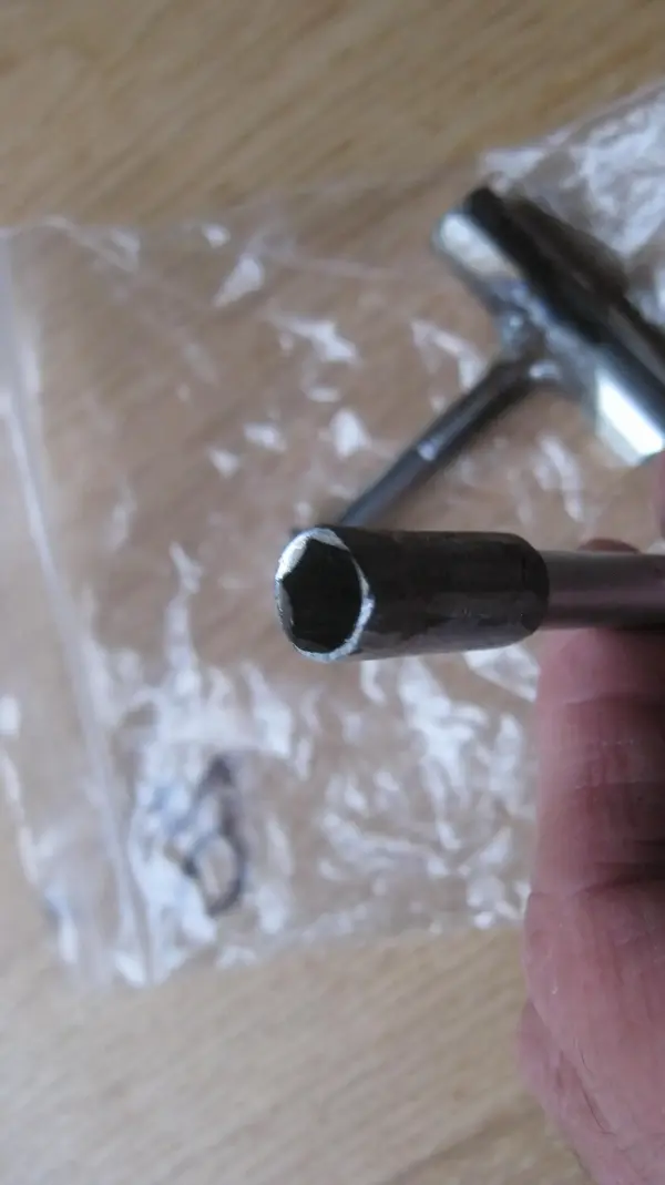

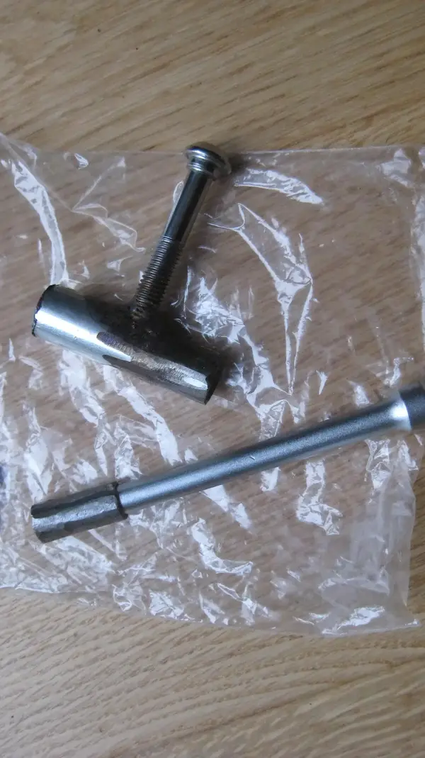

A box spanner, bolt welded to the side as leverage. Shaved-down with an angle grinder so it goes inside the pedal body. Socket on an extender - also shaved-down so it passes inside the box spanner. Worked a treat. Pictures tell the story
