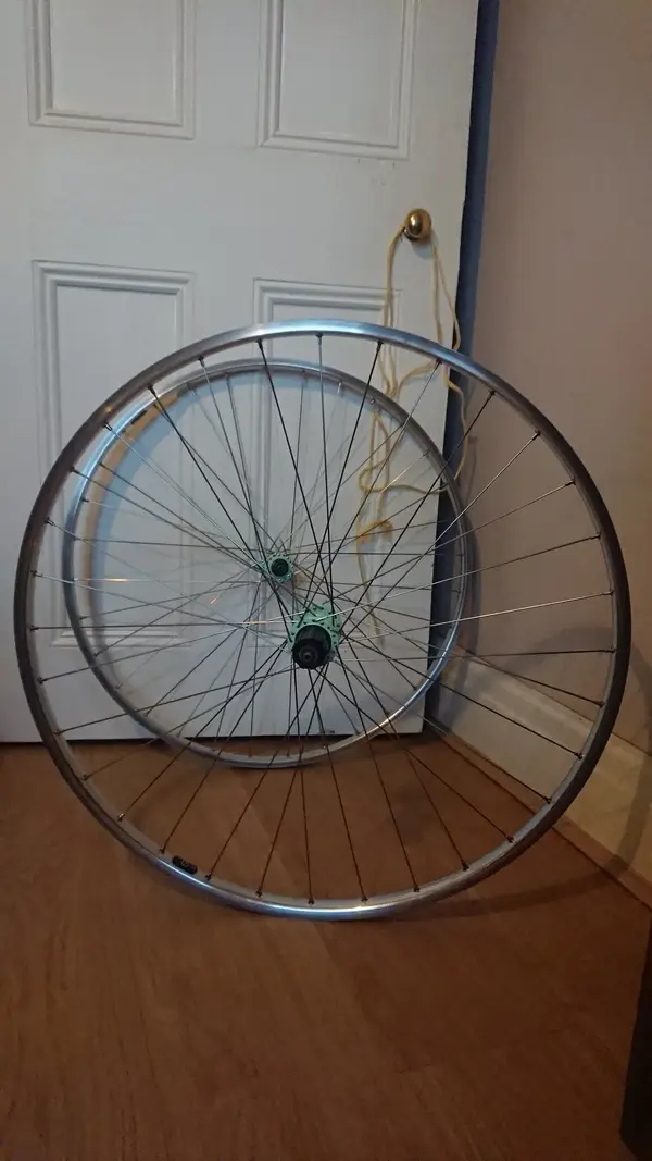

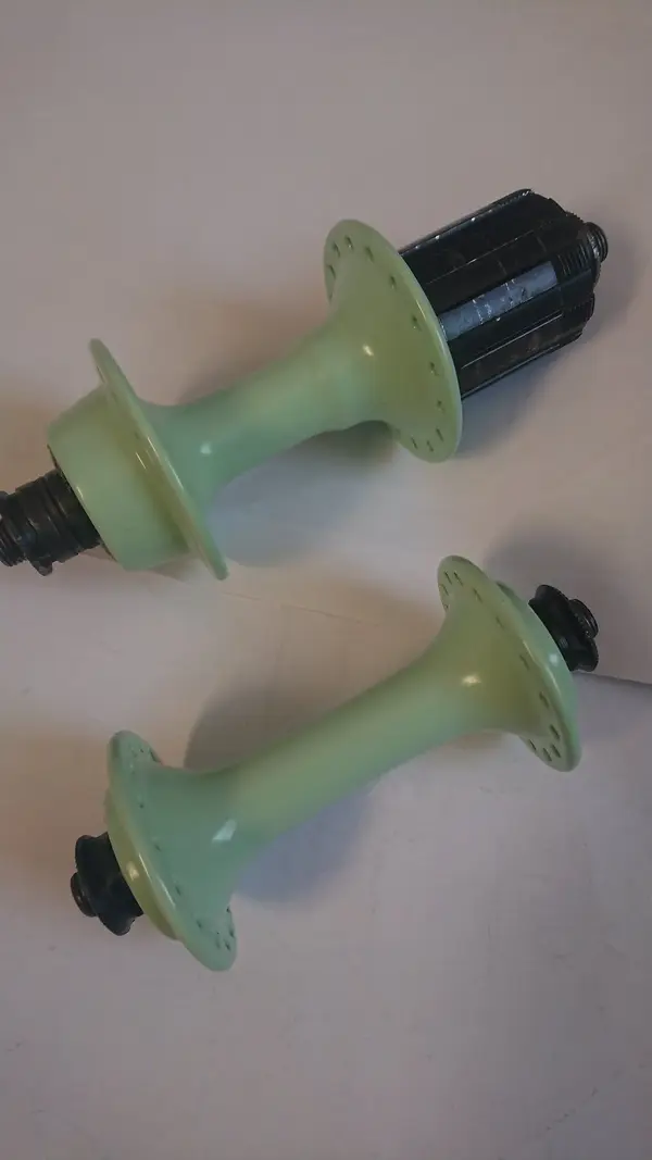

I had my M900 hubs powdercoated - no problems at all with the spoke holes. As long as the powdercoater knows what they are doing it's easy for them to vary the thickness where required (for example the middle of bars too).
