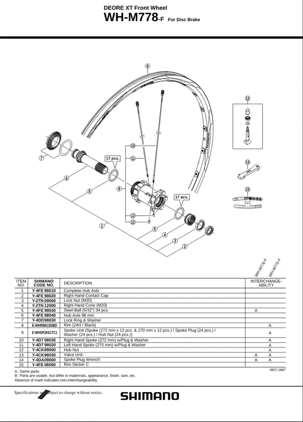

Some of those shimano hubs with oversized alloy axle the cone is integral to the axle - so you'll need the "axle kit"
LikePart 1 on this diagram:
https://si.shimano.com/ko/pdfs/ev/WH-M778-F-2887/EV-WH-M778-F-2887.pdf
If I was at work, I could check availability.
If madison don't have it, you probably can't get it - the only solution is to buy another hub to strip, which could easily be cheaper anyway.
We often buy hubs for fhb/ axle assemblies for this reason.
The front axle usually wears at half the rate of the rear, so you might find a clean and grease is adequate.
