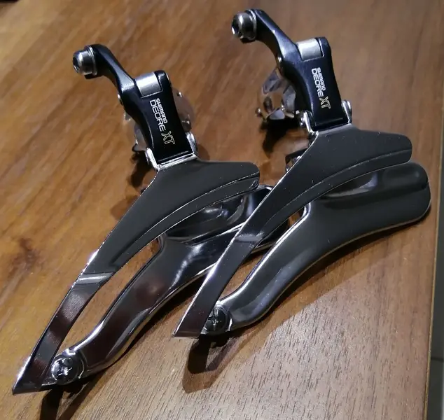

Atmos Senior Retro Guru Sep 4, 2020 #11 Hit me up if anyone need one Attachments IMG_20200901_225100.webp 215.1 KB · Views: 1,101

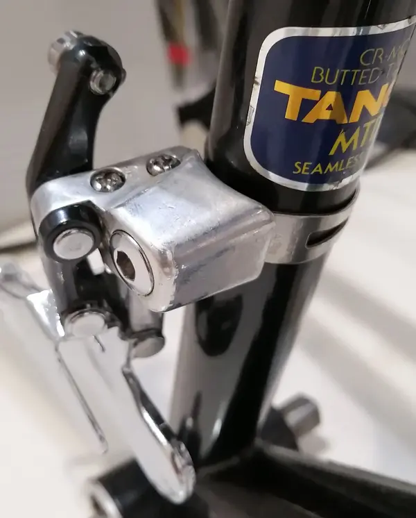

R Rod_Saetan Old School Grand Master Feedback View Sep 7, 2020 #12 Re: And to further clarify, the endless clamp version came with the option of a 28.6 band too. https://bicyclist.cc/shop/shimano-xt-en ... p-fd-m735/

Atmos Senior Retro Guru Sep 8, 2020 #13 Re: Re: Rod_Saetan":2lr5w4u7 said: And to further clarify, the endless clamp version came with the option of a 28.6 band too. https://bicyclist.cc/shop/shimano-xt-en ... p-fd-m735/ Click to expand... Before that i have already purchased it. Should reach me by this week Let's see how it fit.

FluffyChicken Archivist Retrobike Rider Feedback View Sep 8, 2020 #14 Re: as a side Endless also had one addition size of 30.0 that the normal didn't. Of course it's labeled 1 3/16" as EC used inches and not the normal mm No idea why.

Atmos Senior Retro Guru Sep 8, 2020 #15 Just received the endless band today and tried it on. It definitely fits better. OK it shall stay. Attachments IMG_20200908_225519.webp 97.7 KB · Views: 1,003
