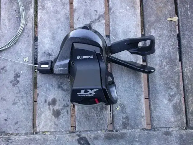

This is the xt 11 spd, it has bar clamp, the small screw to the left allows gear window to be removed and below it is M5 bolt that holds bar clamp in place.

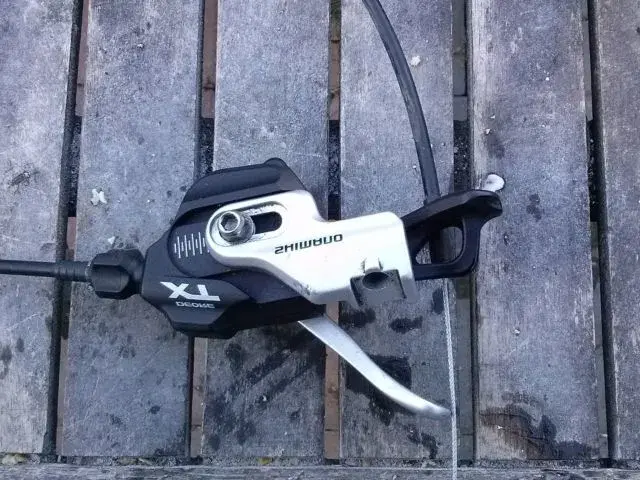

And here is the type of adapter im looking for, the silver coloured thing, as on this 10 speed. I belive this is first generation ispec? And yes, its been reversed so both are in same orientation.

You can get a conversion kit. It isn't just a matter of removing the bar clamp and bolting on an ispec mount, there is a complete new shifter housing half & a replacement internal bit too.
You can get a complete shifter for about £35 from CRC. Might be easier to buy one of them & sell your current shifter on.
Thanks for that but the part that bolts up to the brake lever does not seem compatible.

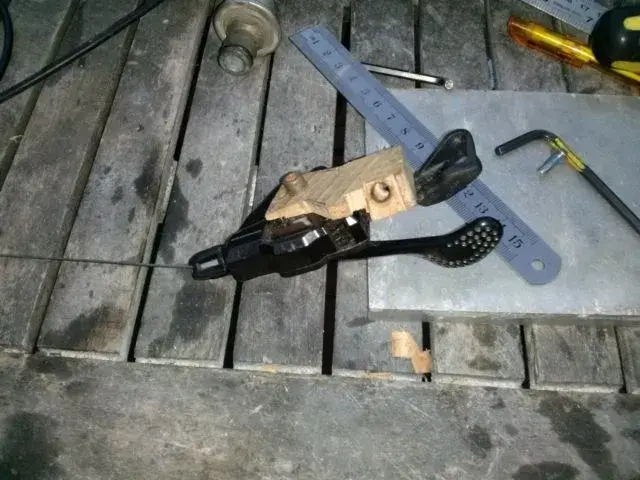

Im going to have a go making my own adapter, mk 1 mock up below, the really difficult bit will be getting the hole in the right place.,... hmmm...

Right, I've just done a bit of research:
If you have M8000 brakes with ispec 2 as you say then the kit I linked to should fit. They did an M8000 shifter with ispec B mount for use with older brakes too but they didn't do an ispec B M8000 brake lever, that would be an M780/785 brake.
Looking at the photo of your mocked up mount and the fact you had a 10 speed shifter fitted, I would hazard a guess that your brakes are M785 not M8000
In that case- yeah, your screwed. :lol:
Not really, you can get an M8000 11 speed shifter that is compatible with ispec B. CRC list them for £40.00.
Then sell your current shifter on here or eblag. There's plenty of people looking to upgrade to 1x11 who would be interested in it.
http://www.chainreactioncycles.com/shim ... prod135894
in all honesty, I'd go that route if I was doing it again rather than paying £20+ for just a conversion kit (not even sure they make one for the M8000).
You can also botch one of the Hope adapters to fit if you have an ispec 2 shifter & ispec B brake, but .......honestly?
By the way.......are you confused yet? Cos I am.
Or, you can carry on with your home made adapter. Sounds like a much more satisfying solution to me- if you have the patience (which I don't!).
