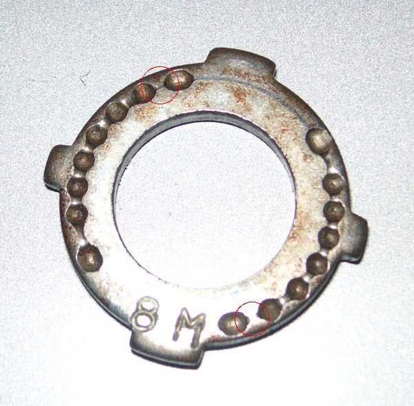

XC Pro thumbies...are they all 8spd capable??
I believe they do (7 speed), so in theory the 8 speed ones could run 9 speed, though I'm sure someone knowledgable in such things will correct me and provide detail about ratios, spacing and other important details I don't have.
Unfortunately no. The thumb shifters have index rings with a given number of deepenings in which the index balls rest.
An 7 speed index ring:
An 8 speed ring (XC Pro Microdrive):
There´s no way to convert an 7speed thumby into an 8speed others than grinding additional holes into the index ring or designing it from scratch.

Yes, that was the "last battleship" of SunTour, the XC Pro 8 speed Microdrive. Those thumbies bear a mark on the outer plastic ring stating they´re capable to run BOTH 7speed AND 8speed cassettes. Those thumbies look like this:
Earlier 7 speed thumbies only bear a [7] marking in that area.
