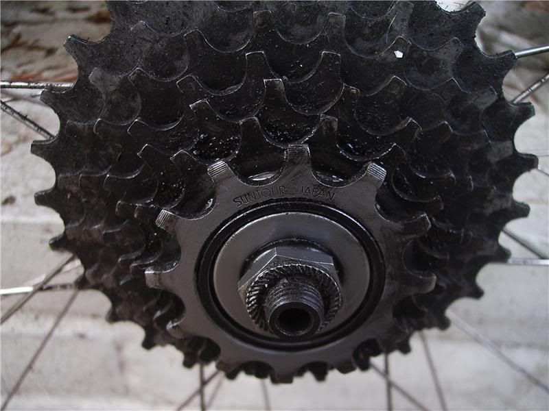

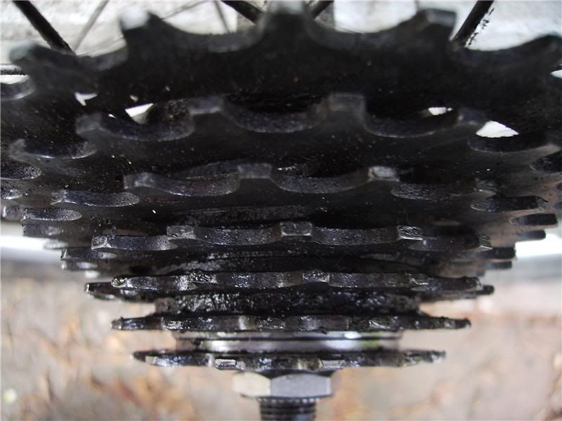

XC Pro cassette - how to remove? - pics up now
No, it is Suntour. See here =>
Maybe I am overlooking something, but it looks like it only can be done with 2 of these =>
That looks like a cassette to me! Guess you are stuck with the tools you have. Try to clean the cogs a bit, gives a better view on stuff. Otherwise it's the ferry to Lowestoft :wink:

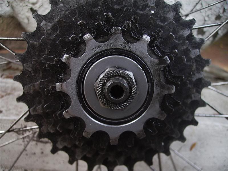

More pics!
Another hub, same system.

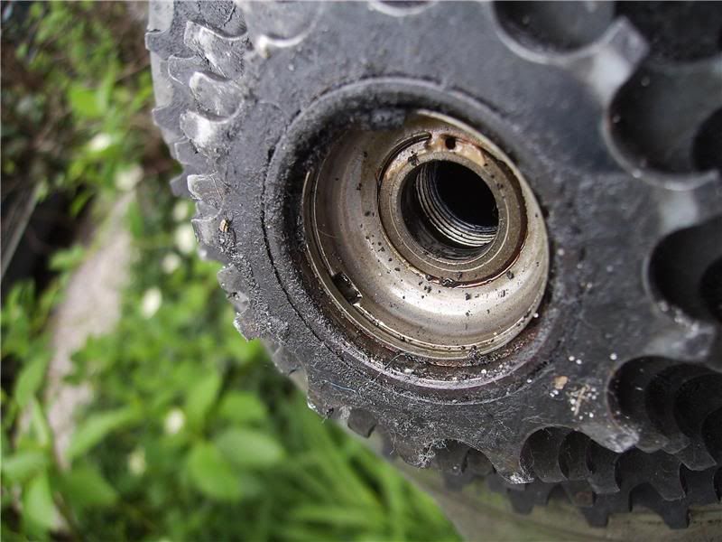

Axle assembly removed.
The 2 notches look suspicious, don't they?
Now I think a bit longer on it, I think they must be there for another reason.
Furthermore I can see the facility to remove the body, so it sounds plausible it is indeed a cassette hub.
Probably I have to use force! ...or I will forever have to use that cassette. Maybe it will work with a 'new' chain as it doesn't have of those tiny teeth.
Those nothes are probably a means to change the cups. It still looks like a cassette that is locked with the smallest cog to me.

hub looks similar to this one:
So the last sprocket is screw on the second last which is screw on the freehub body.
Looking from the right side it´s like there are two rings: the outer one belong to the last sprocket, "inner ring" belongs to the second last sprocket.
The 11 teeth diameter (=micro drive) is to small for the freehub body so they made this...outstanding...part of mtb history (sometimes I think suntour got what they deserved).
Try to remove the second last like you usually tread the last sprocket; so you can both release together.
No, shimano freehub won´t fit the suntour hub and yes, that is just one more reason to switch the brand...sad, but true.
