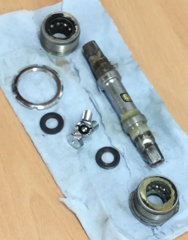

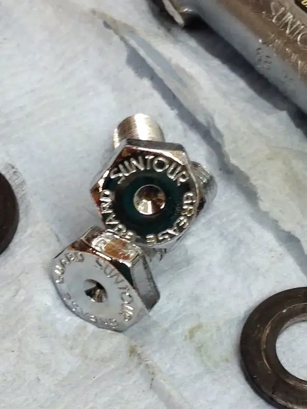

How ironic, I currently have one of these in excellent condition laid out on my work bench, 125mm axle, XC Pro groupset non-MD, I'll stick a pic up tomorrow night, it will be going up for sale.
Here we go.
Thanks, so it looks like I need the bolts and am missing the rubber seal bit which must stop some of the grease escaping the bearings. Though advice above suggests this might not be so vital.
The rubber bits and grease bolts are what really makes this different to a standard bb. If you've not got the rubber seals when you inject the grease it will just (eventually) make its way out. I may have a spare set of the rubbers, possibly the bolts as well.

You are in luck, I've got a spare bb with a dodgy axle and no bearings but the rubber seals are all there as are the bolts. You'll just need the bolt washers which are pretty standard and it's possible I have something suitable in a tin if you don't have anything. I bought the bb for spares for a tenner so if it's of use let me know.
