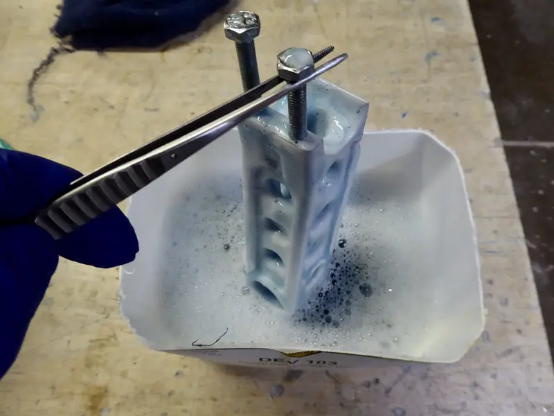

Any sodium hydroxide/caustic soda will strip ano but it often comes crystallized which you mix up yourself, the Oven Pride has a good level of concentration and it's a ready-mixed gloop so doesn't splash on your skin when you're mixing it.
If you do.. as soon as the Oven Pride has done it's wrok, dump the part into hot soapy water to remove the caustic soda before it starts eating into the aluminium.
...and scrub with residue away with a toothbrush
It depends on how much anodising is on the part, i stripped a headset spacer a while ago and it took a good 10mins with the same solution, agitating with a paintbrush to speed up the process whereas those x-lite stems with strip in just a couple of mins.

Worry not! i'm a time served master pattern maker (in the engineering sense) so quite used to handling chemicals, in fact those chemical resistant containers i'm using above are from DEV-103 solution which is an advanced spotting/dry cleaning fluid which i use for removing mould release solution... it also works a charm for degreasing your drivetrain without affecting your paintwork 😁 you don't want that in your eye either
