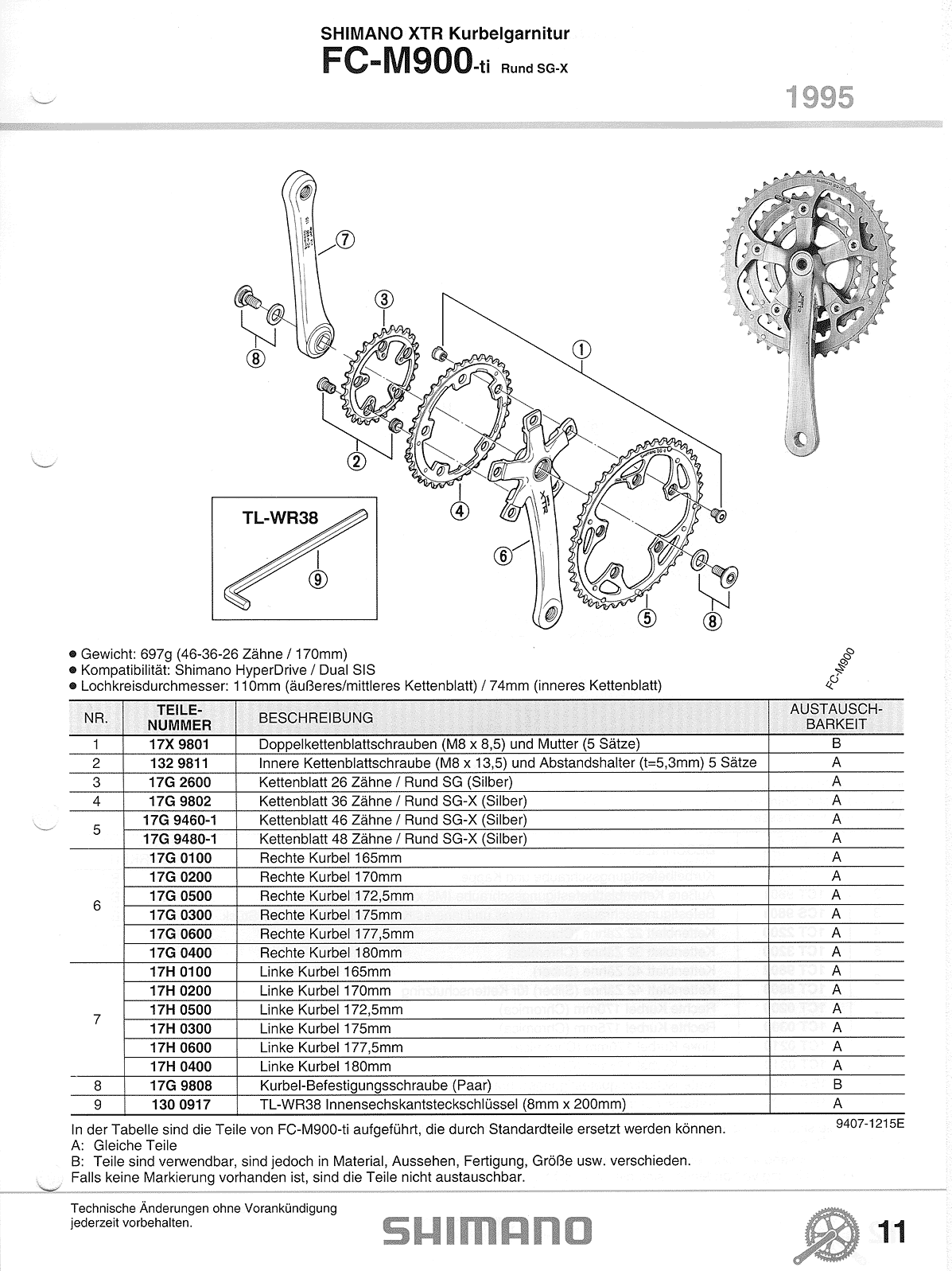

The genuine M900 inner ring spacers have 2 'rings' around the outside and I was pretty sure thy're 5mm even. I'll pull one off one of my cranksets and measure it...

Bolts are M8 13.5mm
Spacer are 5.3mm
EDIT to add you can see the rings mentioned on here

That was from the FC-M900 blown out diagram
EDIT 2 to add the diagram.
Only difference between Ti version : crank/bb bolt was Ti and the other bolts Alu.

hmm, maybe it IS chainring later, i'm using NOS middleburn.. purely as thats what i've got! maybe they're thicker meaning they require even thinner spacers.. i'll dig it out & check..

the m'burn ring is whats throwing it out, its much thicker than the shimano. (another non correct part ;) :lol:
Does the middleburn have recessed spacer parts? the SG rings do and may knock the thickness down to 5mm or a little bit less.
