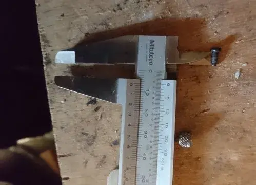

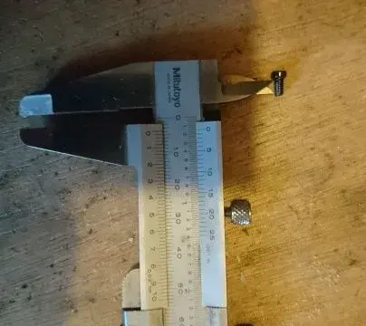

Nice one. The 739 I have was the correct head size but the thread was a bit shorter, maybe a later version might be where to look. I'd appreciate you checking. I'll see if I can get some measuring done at the weekend
Right then.
The XT 739 shifter uses a 4mm long bolt.
the XTR 950 STI uses a 6mm long bolt.
Now, maybe it's different because it's STI and maybe it's different because it's XTR. But I need 2x teeny bolt things in the 6mm variety.
Anyone got handy spares available?

Measurements show the shorter screw is 4mm long and the longer one 6mm.
