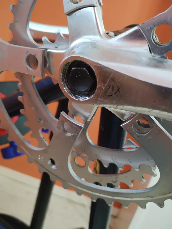

I found the bolts eventually and there are five with one much longer than the other four.
Could anyone help me put it back together please? My Zinn and the Art of Road Bike Maintenance doesn't go into enough detail. 🙄

It's usually:
Outer ring
Crank arm tab
Middle ring
Spacer
Inner ring
All bolts would be the same length - triple not double.
I suspect you have one correct one - there aren't many chainring bolts in existence longer than a stronglight triple.
So you've probably got 4 doubles, stretched out to hold it together.
Google those terms, you should see what's what.
Thank you! That makes sense. So not original bolts. It's an Orbit Gold Medal and from what I can tell they were triples so wonder why the short bolts?
Perhaps they took the chainrings off to clean them and lost the originals 😉.
As it is, late last night I found a set of triple bolts, new old stock, in an original plastic box, on eBay so they should be perfect. I'll wait for them to arrive - I can see how it goes on now, the long bolt threw me.
