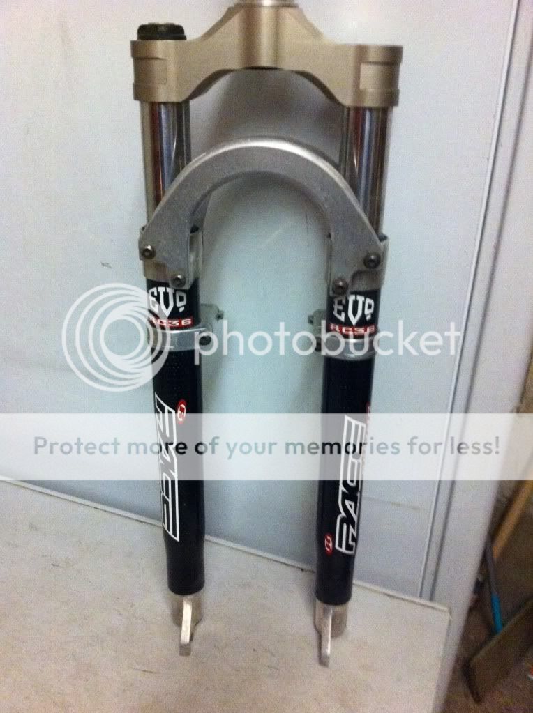

I've picked up a set of RC36 Evo forks from a mate but they're fitted with a threadless steerer, can a threaded RC35 steerer be fitted to them?
Yes indeed. Pace Steerers are pretty generic for pace forks where the steerer can be swapped.
Tighten the crown steerer bolts only to 4.5Nm and put some copper grease on them before tightening.
Oh, and don't lose your crown race collar :wink:
Thanks Justbackdated - 4.5Nm isn't a lot, not sure my torque wrench goes down that far so I shall have to be careful :wink: :D
