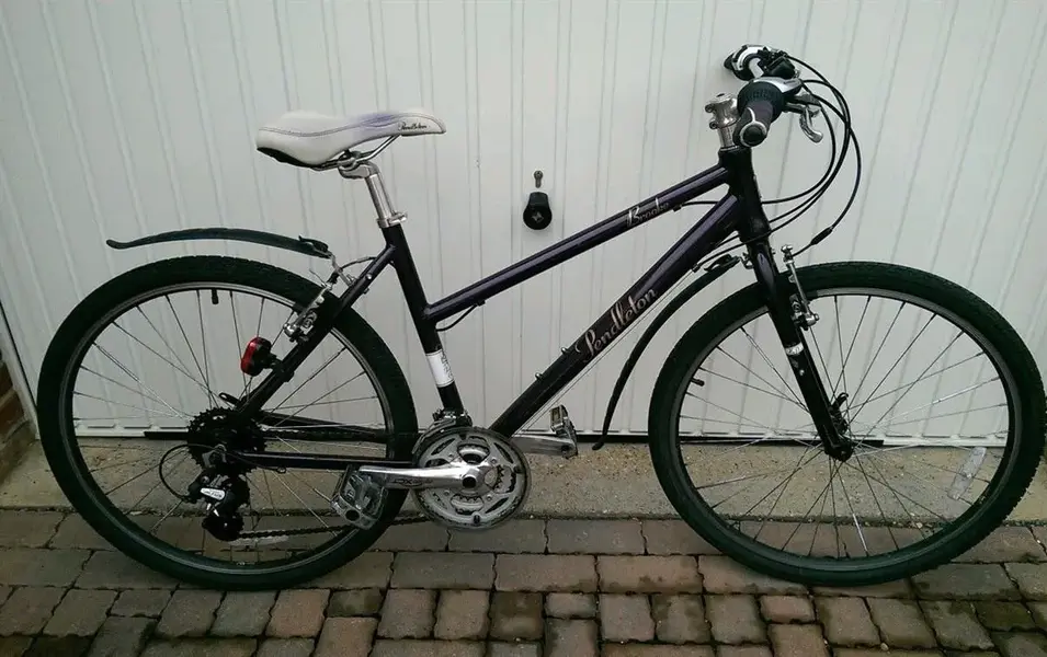

I was recently asked by a newly-retired family member to look out for a decent new or second hand women's bike for use mainly on light paths (at least in the first instance, having not cycled for many years). For better or worse, the frame had to be step-through, limiting my options for a fairly decent, lightish bike (for example, few step-through frames are high-end enough to be made of alloy and/or use threadless headsets!). Of all places, I found a suitable model in Halfords - Pendleton Brooke - in the recipient's favourite colour, and that was pretty much the end of the search. The new price of £230 seems pretty reasonable for an aluminium frame, but even better, I found a nice one locally and won it on ebay for a fraction of that price.
I was pretty happy with it when I picked it up. The stated weight was exactly right on my scales - 12.9kg inc pedals. Since its new owner had memories of heavy, clunky steel bikes and awful rusted gears, I thought I would try and put the record straight, setting about shedding a lot of the weight as cheaply as I could and sorting out a slick drivetrain, with decent parts picked up second hand in good condition, as cheaply as I could. Saving so much money on the original purchase gave me some budget for the upgrades. I'm nearly at the end of the process now so thought I'd start to document it here. Here's how the specs are looking:

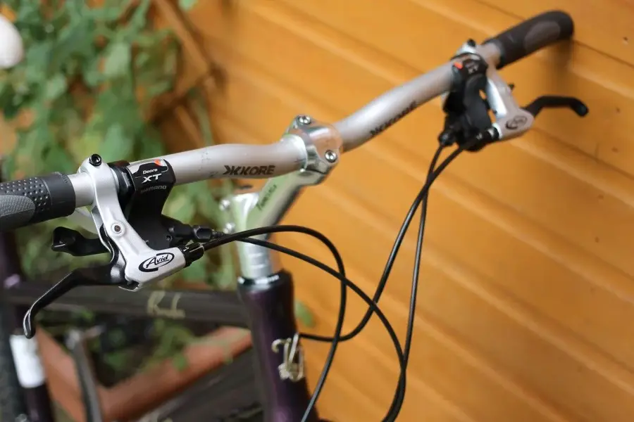

Stem: Longer and higher rise alloy stem fitted
Bar: Kore X-Country riser alloy, 214g, not sure how much weight saved yet, probably 150g or so
Skewers: QRs replaced with allen bolt skewers for security, saved 50g
Pedals: Replaced with MKS MT FT, weight 260g/pr saving 270g off the stock pedals.

Yep, we both had a go on it. Seems just the job fit-wise (not for me of course, my knees were nearly against the bars!), though the current stem is very short with hardly any rise so I've picked up a slightly longer and taller one which might suit a bit better, especially considering the new riser bar is flatter than the old one.

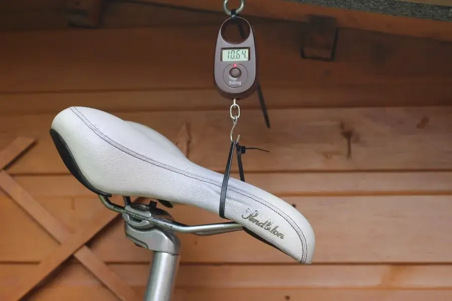

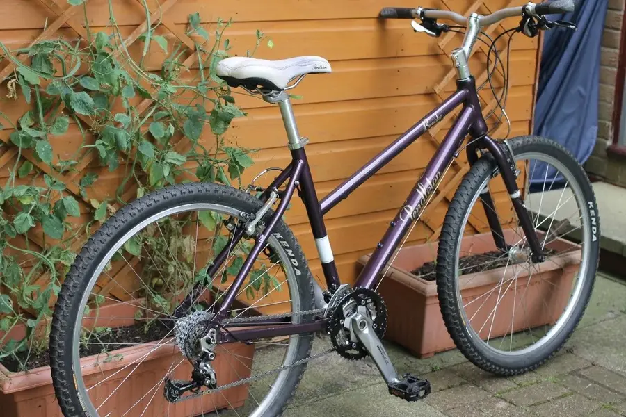

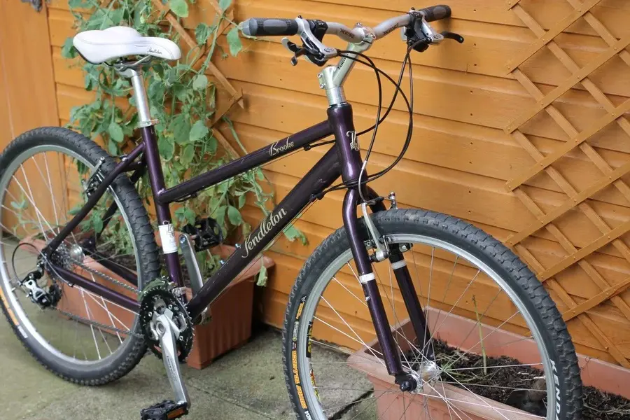

Here it is, complete at last. Now weighs in at 10.64kgs = 23lbs 4oz. The upgrades saved 2.5kgs, in addition to the removing mudguards, lights etc. Very pleased with it.
