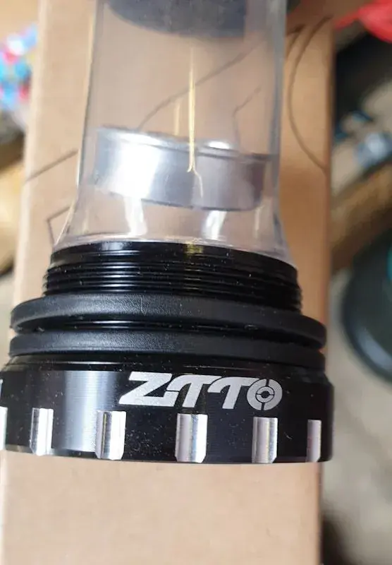

That is the type of bb you need. I bought a few recently and they do come with the gxp adapter (pic of one I just took out of the box below).
Do you have a link for those? I can't make out the manufacturer name hehe
Well. if were all happy that this is the solution i'll pull the pin and buy one of those. Thanks gents, I lost the plot part way through this but it's only because I'm not familiar with the modern components. Why oh why couldn't they just stick with Square Taper.
