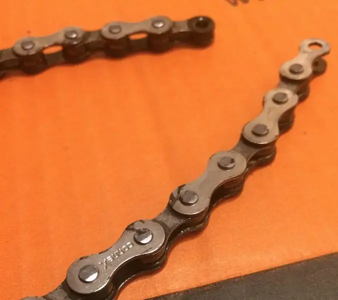

To cut a lengthy story short, it seems that all modern chains are rubbish. The throw away society has well and truly won this battle. At the weekend just gone I took a cosmetically perfect Wippermann chain off my bike that had been on there for three months and for which the Park Tool rattled like a toy, it was completely shot. I've attached a photo to show the state of the chain so as to dispel any idea that it was abused in any way, which it wasn't. I actually take great pleasure in cleaning and prepping mechanics (my idols were always the mechanics and not the riders).
What I have found interesting is where the chain stretch is now taking place. I used to find that chains have ‘stretched’ when the plates ate into the pin (something that was greatly exacerbated when manufacturers ditched bushed chains). Plates ate into pins because manufacturers were using good quality steel. Now, when I dissect a chain, the pin is pretty much perfect which means that the stretch is, in all likelihood, taking place in the plates themselves which seems to indicate that manufacturers are now using low grade steel with little yield strength. The benefit to the manufacturers of using this steel is that it is cheap to buy and, being soft, also creates very little wear on cutting and forming machines which all saves money for the manufacturer and thus allowing a ridiculously cheap product to be offered to the customer.

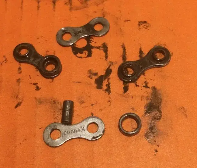

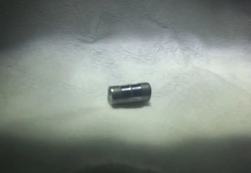

So I dismantled the Wippermann chain last night and took some photos. The wear on this particular chain is, as Xerxes has said, concentrated promarily onto the pin. This Wippermann pin lasted 3 months with just standard 10 miles a day commuting on flat roads which is about 600-650 miles in total, which is terrible. In answer to the OP's question I wouldn't particularly spend any extra money on a Wippermann chain over a cheaper brand.
