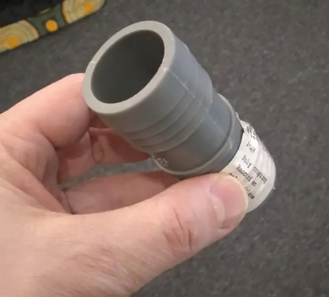

I didn't have any sockets which were long enough, so I bought a plumbing connection. It is a 1 1/4" polypropylene coupling. Can't beat the price!
