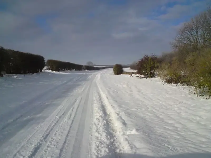

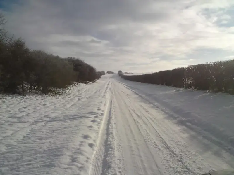

drove normally in this 2 way road (although you wouldnt believe it until you saw it) yesterday, didnt use the brakes to slow down, just the engine and to pull away just the clutch until the car was moving.
