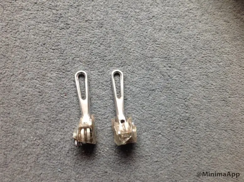

Looking at the expected post arrival time, I think SJS must be delivering them by hand via the very top of Scotland whilst only being allowed to crawl. Luckily, to tide me over until that distant date, I found these in the stash:
I really like the look of these shifters but don't want to use them permanently as I want to return my Alan to more or less the build I first got it in.
