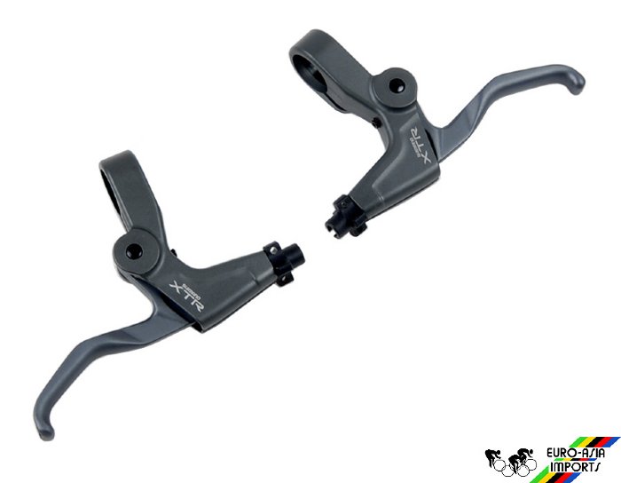

And their big brothers could never be called boring, just subtly cool:
Avids, whilst perfectly functional, always seem overbuilt to me, and somewhat lacking in character.
