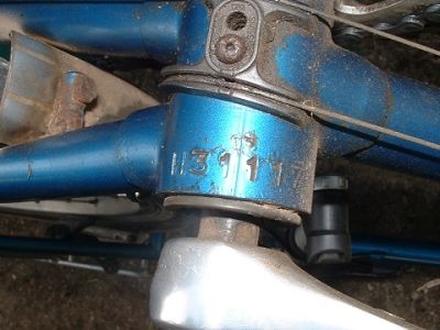

Cheers chaps, I'd heard about Randonneurs having the spoke holders. However, I've had a good squint at the BB shell and it looks like the serial begins with 'H'.
Wouldn't that make it quite a late bike from 1998? Were Raleigh still making high end tourers by then? I'm struggling to find a catalogue.

It's certainly a late nineties Randonneur or Royal. Royals were green, Randonneurs were teal blue. They shared a frame, the Royal having cheaper components. I had a Randonneur which I foolishly gave to my father: I've been regretting my generosity ever since.
Randonneurs were made at RSP until about the year 2000. The final models were very posh, with a full XT 9-speed groupset and Magura hydraulic brakes. I don't know much about the Gran Tour (one was hanging in Williams Cycles in Cheltenham in the late nineties), but I assume the frames were built at RSP alongside the Randonneurs and Royals.
708 Touristique used an oversized top tube (28.6mm) and may have used heavier gauges in the other tubes. I've got a feeling the dimensions are given in Tony Oliver's "Touring Bikes: A Practical Guide". I can check the serial number of my dad's bike in a day or two, but I assume it will have the same format as the one pictured above.
