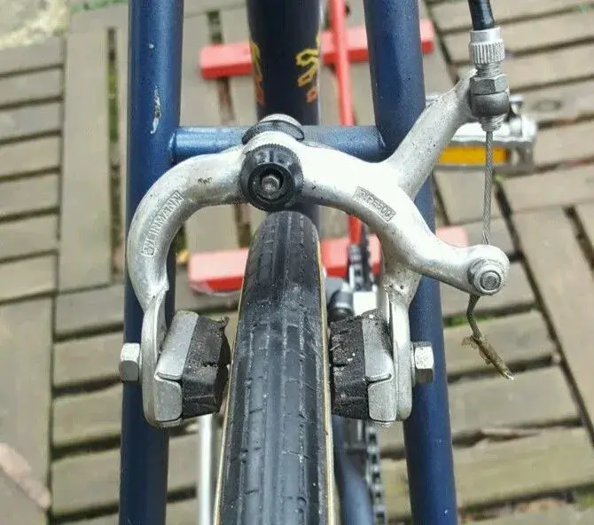

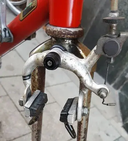

Been looking around a bit and there seem to be a few Peugeot models with mid reach caliper configuration. But hard to get the info from random classifieds sellers.
One is from a Galibier, the other from a PH11 model. Would you reckon those are medium reach (47-57mm)?
PS: Weimann 500 seems to be 42/43 ~ 56/57 depending on the source, so maybe I'm closing in.
