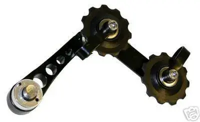

Odd, not really. It would look pretty good IMHO. Do it and if you think it sucks, change it back, or, use a Mr Control Mountain Bike Chain Tensioner MK2 Single SPD to give it the 'geared look'.
hmmm, Im using an old campag Mountain rear mech as a tensioner on the Bonty at the minute, so maybe it wont be so bad... ill play with it.
