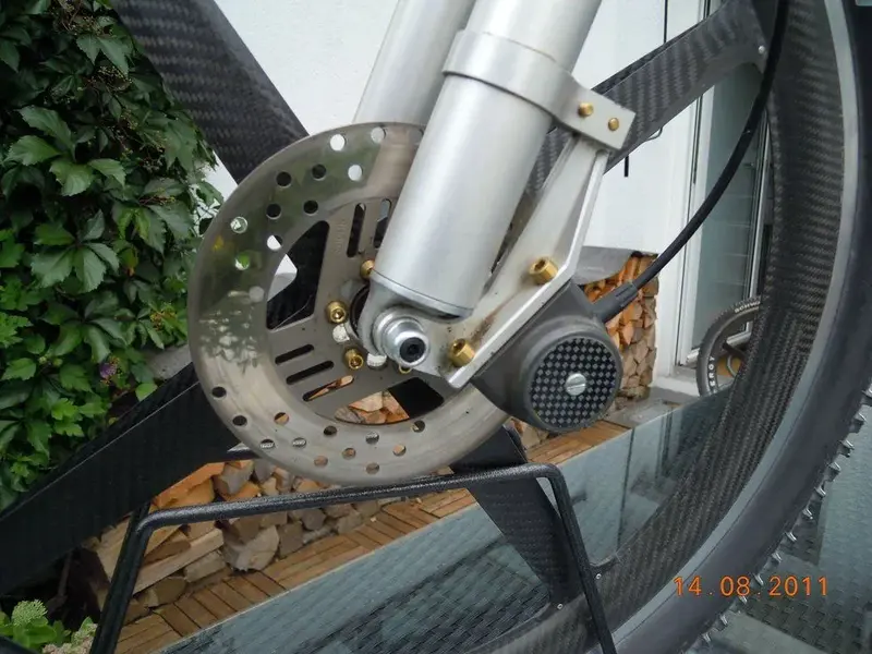

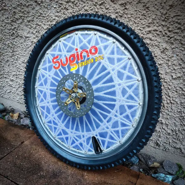

I just got a Sugino disc wheel which has a modified Hügi hub with custom Sachs disc.
The modification was done by a Swiss guy who also designed some brakes for race cars.
The custom star is made out of titanium and also the brake disc was custom made.
Now I think about if I should remove the brake disc and use the wheel for some project.
Or if I should look out for a frame that had a rear sachs mount.
I know the Cannondale Super V-4000 DH had such a Sachs mount. But there must have been other frames with this mount.
Any information would be great.

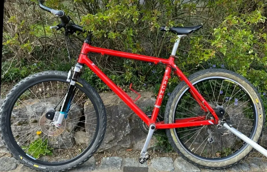

There was a Sachs labeled MTB, always in red color with M4 disc and full Quarz/New Success with Power disc.
The bike made it in any brochure or catalog, but may have been rather a demo version to showcase top of line Sachs products.

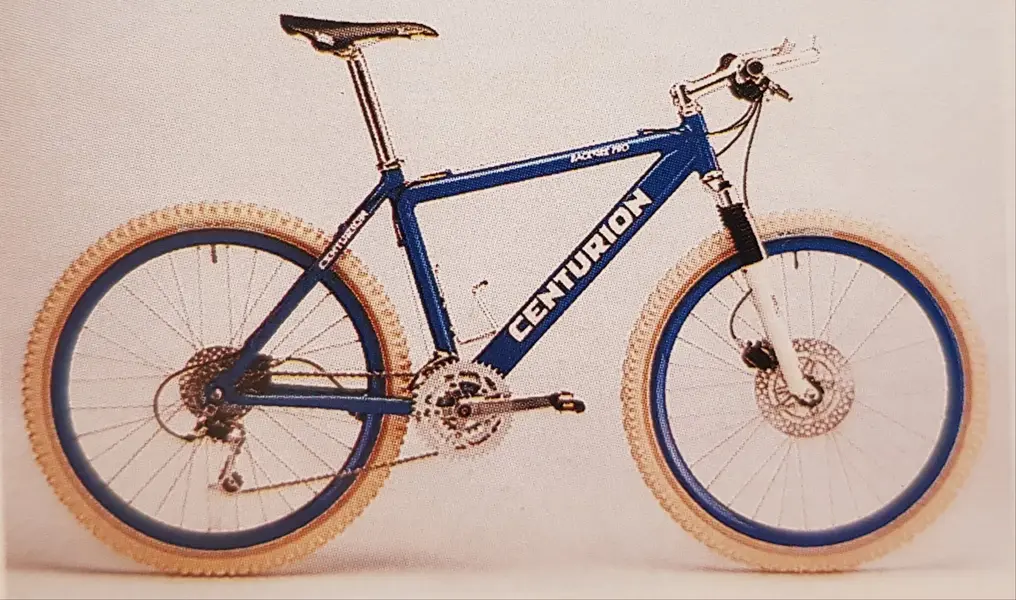

also Centurion the Backfire Pro 1997, equipped with the Power disc.

Thank you very much.
I'm looking for something more "fancy" to add this wheel to.

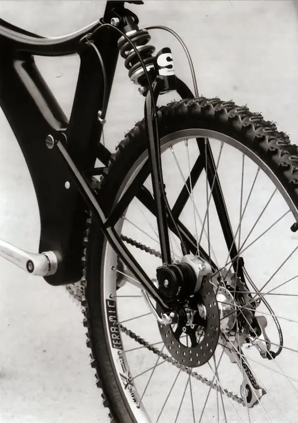

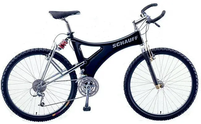

Schauff (sorry again for the boring German brand) had a carbon Monocoque full suspension in 1994 called SUSPAC.
This was also shown with Power Disc
I never have seen one in real, nor an offer, but style wise, your disc wheel would fit there pretty well 👍

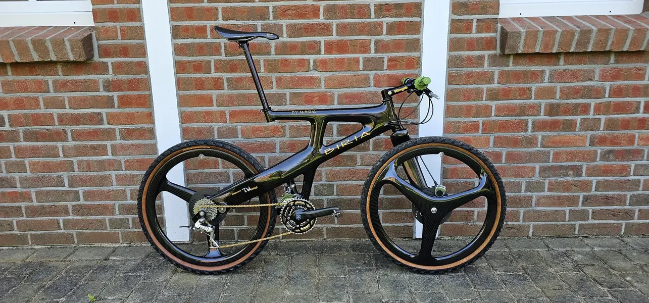

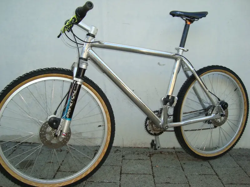

Some example from my little collection.
The Biria has Carbon-Aluminium discs (not made from steel).
