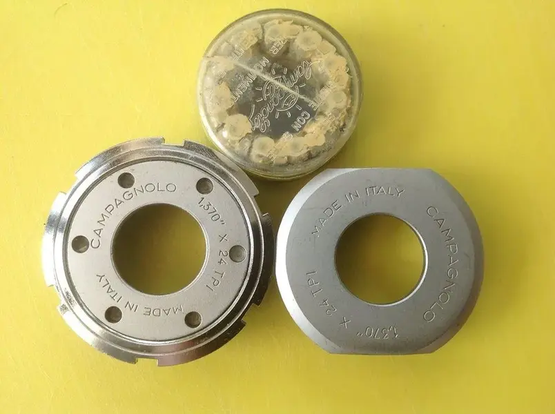

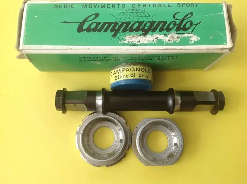

Hi folks,
I am preparing an auction of some unused clobber and have come to my first Campy bottom bracket and cannot identify it! Could someone please tell me what it is from the box please? It measures 114.5mm x 68 English. I believe it is the early taper style.
Cheers,
Jon

Hi, it looks like it, but I was unsure if the old style box would pre-date the Triomphe. I love to get a positive ID but Campy not marking the box hasn't helped!
Thanks for your reply mate,
Jon
green box colour was always Nuovo Tipo / GS and Nuovo tipo axles were black.............my era LOL
So that's the 70's then :)
Shaun
Would they maybe use the same BB between groupsets, or would they re-model each item? I don't recall buying them as a 'serie sport' and 'Nuovo Tipo' rings a bell, but that is not to say the item was correctly described in the first place!
I see your axle is 68-SS but I see no 120 stamped after that. That would make it after 1978 ish when they dropped stamping 120 on the axles........now that's from memory so might be urban legend LOL
