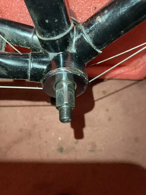

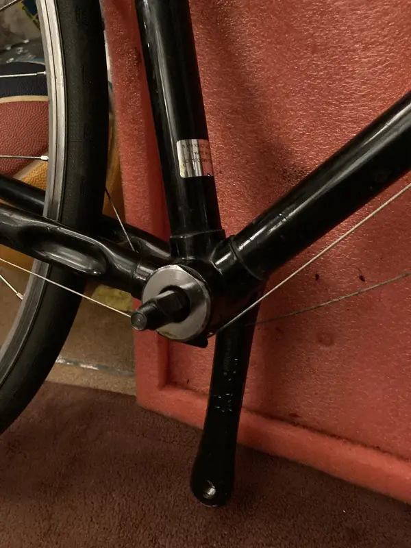

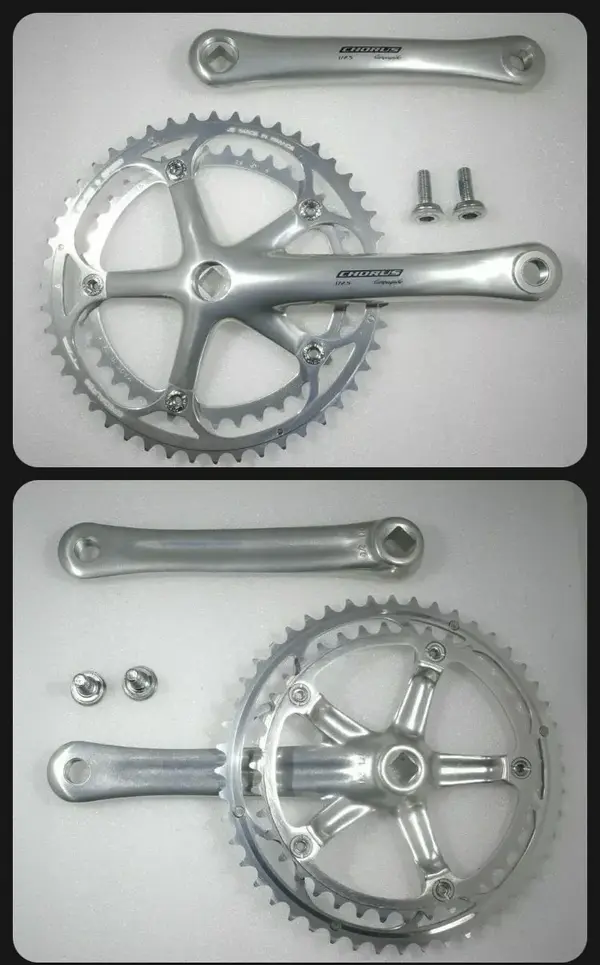

Hey guys,
My original crankset broke so I’m in the process of replacing it.
I’ve been gifted this Campagnolo Chorus crankset which I believe is Square Taper ISO.
I think my bottom bracket is Square Taper JIS, with a threaded boss for a nut.
Can someone help me identify the correct bottom bracket (size, taper etc) replacement so that I can use this Campagnolo Chorus.
Thanks

You'll be needing either a Chorus or Record sealed cartridge bearing bottom bracket with a 102mm axle length. Bit more info on the link which explains it, as your replacement crankset dates from the early 2000's.
