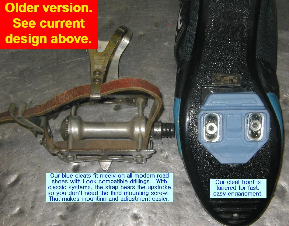

have you considered these?
http://www.yellowjersey.org/tocleat.html
You can get(somewhere?) slotted shoe plates for 3 bolt modern shoes. I have a set that came on some NOS Vittoria shoes I got at a jumble. Guess they were from that transition period. I am sure that I have seen such a thing on the web somewhere.
Those Yellow Jersey cleats are the only ones I could find in current production. The Exustar and/or Keirin track cleats won't work well, I think, as they're not designed to slide in and out easily. The trouble with the Yellow Jersey ones is that they have no European distributor, and shipping costs nearly as much as the cleats. If anyone else was interested in joining in, I'd be happy to organise a group buy. From memory they're about $30 a set, with shipping at $19, so it starts to make sense if we're buying three sets. Post here or PM me if interested.

They'll fit. Use the rearmost two bolts on a delta pattern shoe. Slot behind the bolts.
The slot *might* be a bit tight, 10 seconds with a file will sort that.

I have used the Exustar plastic cleats as sold by SJS cycles for two years now, there is no problem getting out of the pedal.
Re: Re:
But aren't those cleats effectively backwards? Surely the yellow taper needs to point towards the front of the pedal, which puts the slot ahead of the bolts, which surely means it won't be in the right place to engage with the back of the pedal?
No the slot goes behind the bolts, have a look some posts higher to see similar cleats installed. One small note, this type of cleats are quite wide and for some narrow pedals it's not possible to use them, for instance I can not use them on the BSA pedals on my 1960 BSA Golden Fifty.
