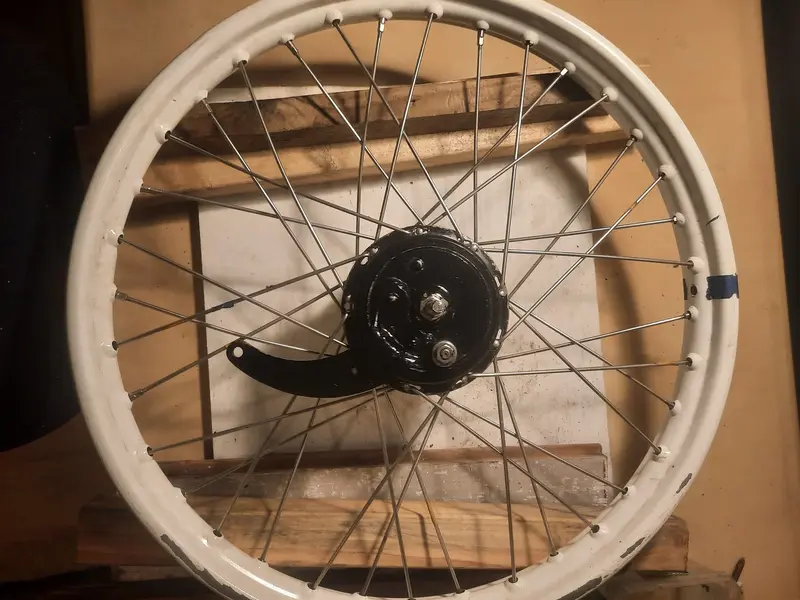

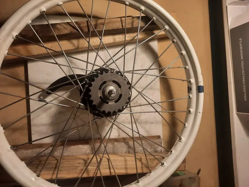

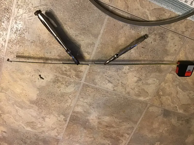

I went 3X crossed DS, 2X crossed NDS. NDS spokes poke out too much. The headout/inners are trailing on NDS. It didn't look as though The spokes were long enough for 3X.

Are you sure they shouldnt be three cross nds, it would certainly explain why they are sticking out.
Although the entry angles on the eyelets look about right....but that's hard to really tell in a photo...🤔
I've tried 3 cross nds but the spokes aren't close enough to be able to thread on the nipples.

Did you say the hub flanges are different sizes? If so, stupid question, but you have got the right spokes in the right side!
Also you are crossing the right number on the right side? Could it be the drive side was 4x?
That combined with the wrong spokes on the wrong side would cause al kinds of problems.
Silly questions, but just to be certain!😂
Also, the spokes you ordered did come back exactly the same length as those you took out? And...the measurement was correct from the old spoke?
Do you still have the old spokes? And any photo of the bike with the wheel in you can zoom in on?
Got to ask.
The hub flanges do have different diameters. I have measured the spokes numerous times, there isn't much difference between them. As I understand, the number of times you cross the spokes is dictated by the number of spokes. In my case it's 36.
