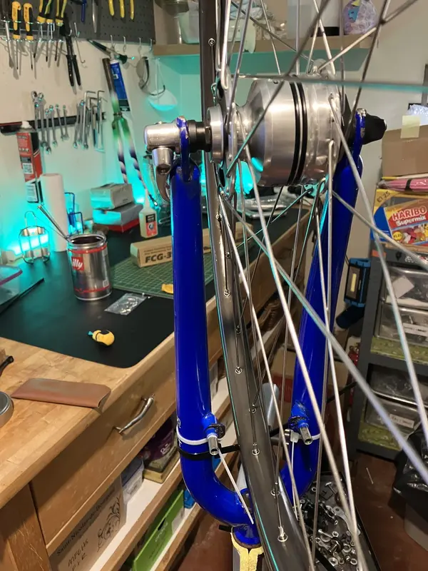

So, I don’t (yet) have a dedicated truing stand, but rather use the bike frame (rear) or a fork clamped into the work stand (front) for truing. A couple of zip ties work as feelers.
Now, when working on a rear, this is oddly easier: the frame tubes allow you to judge dish pretty well, and the brake bridge works as a roundness gauge. As this is my first build-from-scratch front, I can’t figure out a hack for dishing, so have ponied up for a Minoura dish tool. Need to do Xmas gravadlax and pastry today, but will slope off and try it out later.
