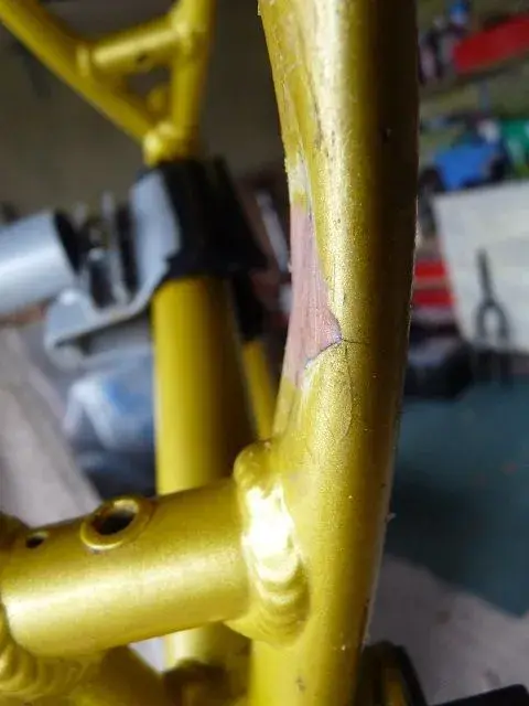

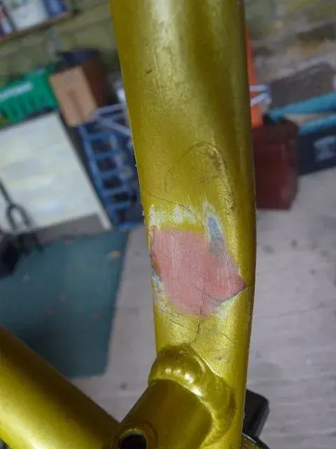

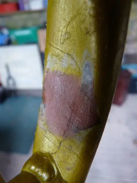

What's this....?!! Looks like filler to me....
Thanks chaps, all this talk of filler is making me go green, as the car has just failed MOT due to rust..... :facepalm:
Frame is going back for a full refund plus my postage. Total pain as this was going to be my project for over this weekend :roll:

Re frame, you definitely confirmed it crack? If there is a vent hole in stay, you could blow air into it and see bubbles when stay is under water, easier said than done (or baking soda followed by vineger to create co2 then cover up hole, some water washing up liquid over crack)
This assumes crack is large enough to let air through.
Im surprised seller wants it back, if cracked, what use it it.

Yes, I was surprised he wanted it back too, but it came from a house clearance type seller on eBay who by his own admission, knew very little to nothing about bikes....perhaps I'll suggest he just refunds me and I keep it for growing my beans up! Certainly I wouldn't want to start messing about trying to fix it, I've a steel frame I can build up for now.
