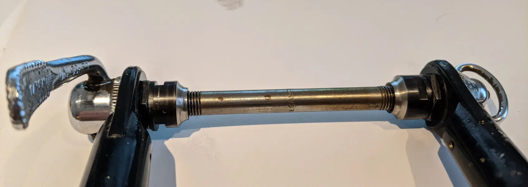

As I've got way too much time on my hands, I thought I'd measure the amount of movement of the cones when the quick release is done up.
My understanding is that it's the slight play in the threads that causes this to happen.
Using the setup in the photo, I measured 0.07 mm difference between the inside of the cones when the skewer is done up.
The thread is 26tpi, so this equates to about 1/14th of a turn.

I love this :)
Thank you for taking the time to do this, it's actually very informative. 1/14th of a turn is actually quite a lot, roughly 25 degrees, which can make a difference between a smooth-running bearing and one that is too tight!
