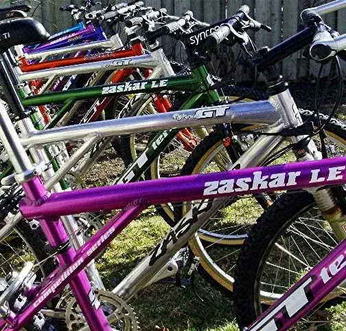

What paint schemes where original?
Speaking from experience...there was No such thing as an "original" paint scheme Zaskar as none of the "originals" were ever sold painted. Ball Burnished or anodized colors only. First anodized frames were done in mid 92 and the anodized frames first appeared in a catalog for the 93 model year. The original ano colors in 93 were turquoise(aqua), purple and black. Ink Blue and Purple/BB fade were added in 95 and Red in 96. The frost ano (flat) in red and blue are from the 97 model year. The first painted Zaskar happened in 98.
If that frame serial number is inside the left rear dropout and starts with an "H" or is stamped 7005 inside either dropout it's a Pantera. Zaskar serial number noted in earlier post were all numeric at that time.
