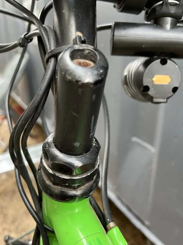

What type of steerer tube is this please ?
Russ43
Hi could anyone please tell me what type of headset this is please ? I’m not sure if it’s a threaded one or not ! Many thanks D9413BC9-9FD1-4EC4-9884-72C678E89C23.webp
Yes threaded. If the forks you fit have a threadless steerer you will have to fit a threadless headset and a different stem. If they have a threaded steerer you need to make sure it is the correct length for your frame/headset.
