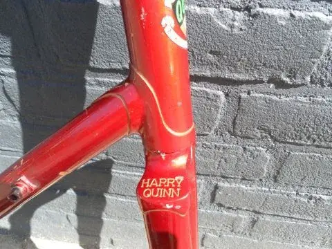

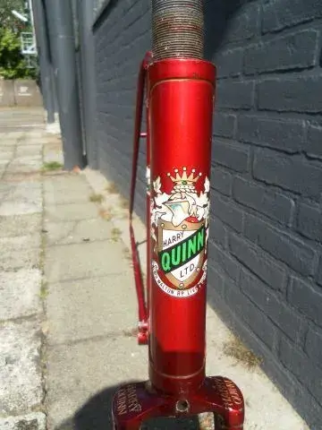

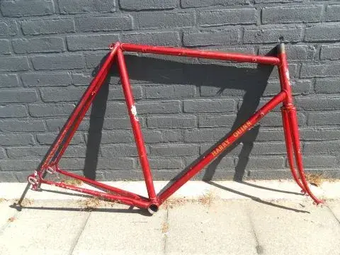

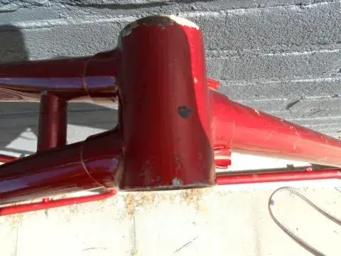

I found this Harry Quinn on ebay a while ago. The bearings were totally worn and it had different replacement parts so I decided to strip it.
Serial is Q4786 so I suspect it's a proper Harry Quinn. Apart from the Walton Road decal (on head and seat tube) there are no other decals. Does anyone have an idea of what tubing was used on this one? Frame excluding fork weighs just 2,3 kilo. I took it to Dutch frame builder Marten Gerritsen of M-Gineering to drill out the stuck seatpost. He thinks the frame is most likely Reynolds 531.
The bike had Suntour Blue Line gearing (probably original), which appeared in 1980, so I date it back to that time. Could that be right?
Thanks for any info.

Nice looking quinn :) as Ian says the cable guides are on the top of the bb abd if the brakes are nutted then it's late 70's possibly 1980 but by then the brakes started to have allen key bolts......... pound to a penny it's 531 :)
Do the rear dropouts have any holes for a Portacatena?
Shaun
98% chance of being 531
Too early to be a different Reynolds tubeset and too high quality for it to be anything less.
