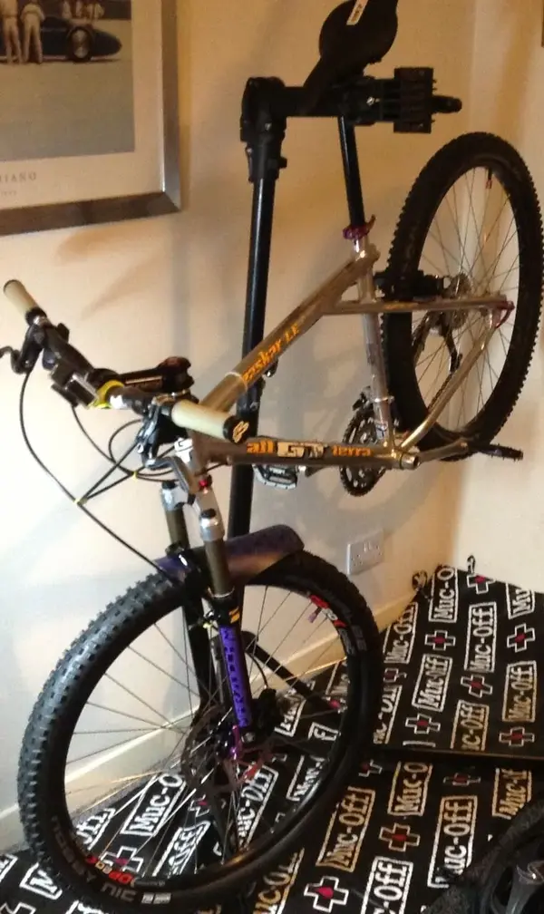

It merely shows they're being ridden as intended. I've got magura front disc, hs33 evo rears and marzo fly light airs, on my 94 Zaskar LE. Just because the frame is a great little XC rider and can take the punishment to this day. I ride it more than my Bronson!
