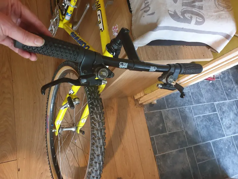

I was planning to fit a polished aluminium GT handlebar but it turns out that the shifters would not clamp tight enough, it seemed that the diameter was smaller than the standard, but I took this True Temper from my 1991 Trek 950 and I think it looks better in all black anyway.

Despite fancying the Shimano M095 I ended up going for the thumbshifters, just because I already had those ready and it was the logic route, saving some money in the process. I think it doesn't look out of place either!
